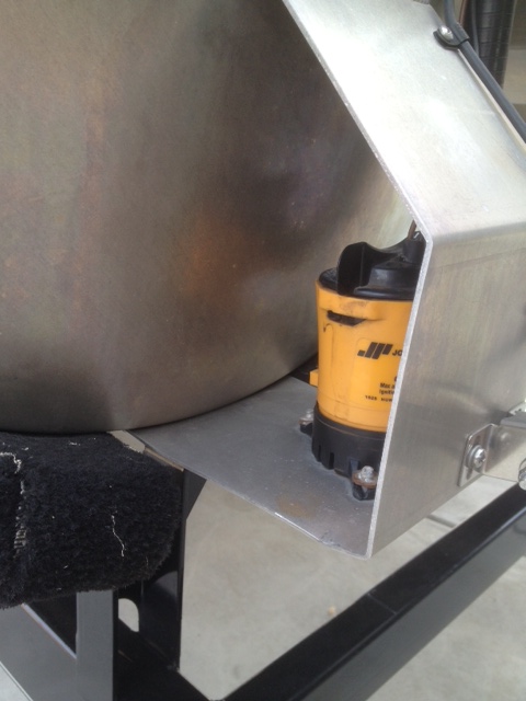

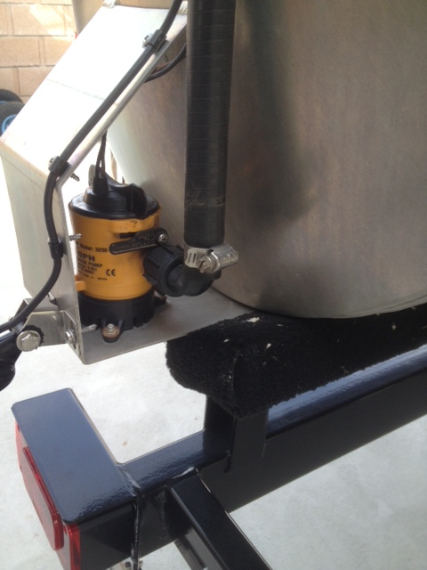

I noticed that my pontoons sit about 2-3 inches forward of the tail end of the bunk boards. Typically should not be a problem. However, I have an aluminum plate that is welded to the bottom rear end on the port pontoon. The plate is used to mount the live well pump and transducer. I think the plate is welded at the bottom of the rear cone seam. The plate is resting on one of the bunk boards (dual bunk boards for each pontoon). I'm assuming it has been this way since new. Do you see this as a problem? I thought that over time, the rear cone seam weld, at the plate area, could crack from bouncing along the road.
As you can see in the pics, I have about 2-3 inches of where I can move the boat back so the pontoons sit even, or with a 1 inch overhang, with the bunk boards. This would be a simple process of loosening the bow stop/ladder mount U-bolts and moving it back 2-3 inches and re-loading boat. To completely avoid plate from resting on bunks, pontoons would need to overhang the bunk boards by 1 inch.
Thoughts?

Weight your tongue and see what it is, you can move it back as long as you don't get the tongue weight to light, that will cause you to fish tail at speed

I agree with Herb, it comes down to trailer balance & tongue weight. Figure that out first. If you have to take a saw and shorten that bunk after, so be it.

so, any comments on the live well bracket and possibly cracking the seam weld I spoke of?

You can shorten the bunks a bit.
Re: How to properly adjust pontoons on trailer bunks?
SoCalAngler wrote:so, any comments on the live well bracket and possibly cracking the seam weld I spoke of?
Not a problem. (Welder hat on) the soft pine will conform to the pressure point of the bracket weld. In fact we'd use pine under large girders that were wobbly when stood during fabrication because a convex flange would sink into the wood and sit steady.
Between the carpet and the wood I doubt you have much additional pressure at that point.
