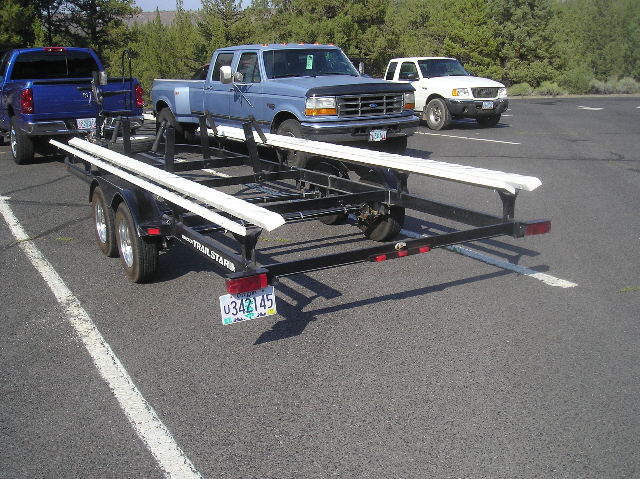

Eastern Marine 3 season ago. I pre-cut, and pre drilled on pre cut and sealed Douglas Fur. Using carriage bolts tightened down with air tools so to pull the carriage head flush with the top of the wooden bunk prior to the cap instal. I've seen too many lag bolts back out over time or fall out of carpet covered rotted bunks. People talk about "if you didn't have your toon latched to the winch backing down the launch it would slide off" I doubt it, but who would put your toon in the water before unhooking the safety and winch off the trailer
I've seen new carpeted bunks with rips. To me carpet on your bunks is like taking your wet shower towel and throwing it on your hardwood floor and letting it set for 8 hours. Wood is going to rot with wet carpet soaking on top of it.

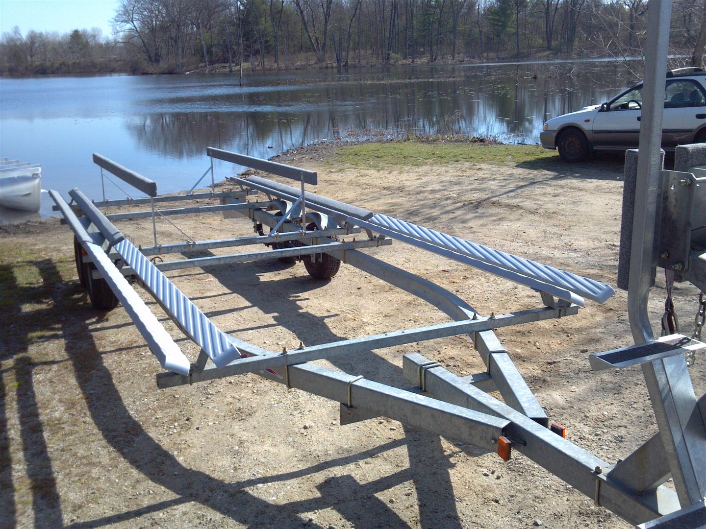

When I rebuilt mine I took the trailer to a nice quiet boat launch. Floated the toon off and replaced all the trailer bunks rite there. I had everything all ready to go and plenty of cordless tools to make the job a snap. I used the bunk sliders on the front bunks and carpet on the rear ones. The idea is when you back down the launch into the water the rear floats rite up off the carpet and slides nicely down the front bunks. Same thing when loading. The carpeted bunks are under water and just the front bunks with the sliders are exposed. She slides rite on nicely. While I was at it I also installed some self made guide ons to help loading in the wind. Trailer works real nice now.

Chillin....it appears I have the same trailer as yours. I have a few questions about your project if you don't mind.... If you could post some detailed close up pics that would be great!chill'nthemost wrote:Eastern Marine 3 season ago. I pre-cut, and pre drilled on pre cut and sealed Douglas Fur. Using carriage bolts tightened down with air tools so to pull the carriage head flush with the top of the wooden bunk prior to the cap instal. I've seen too many lag bolts back out over time or fall out of carpet covered rotted bunks. People talk about "if you didn't have your toon latched to the winch backing down the launch it would slide off" I doubt it, but who would put your toon in the water before unhooking the safety and winch off the trailerI've seen new carpeted bunks with rips. To me carpet on your bunks is like taking your wet shower towel and throwing it on your hardwood floor and letting it set for 8 hours. Wood is going to rot with wet carpet soaking on top of it.
Your bunks must be 2x4's, correct? How many sets of the covers did you need? How do the plastic sections connect? Did you replace your wood because it was bad? Did you consider replacing with 2X6? Did you use the screws supplied or something else? washers? Did you remove the bunks and lay out on a flat surface when you installed the plastic covers?
I believe my bunks are attached with lags (came this way brand new from dealer). I am the second owner and the boat/trailer/motor are only two years old. I believe the wood should still be in good shape.
I've always through-bolted my bunks on previous boats for reasons you mentioned. I need to find a fresh water marina so I can take boat off trailer and do all of this without being rushed.
Thanks!

I have the exact same trailer as yours with the same bunk covers. I am very pleased with them so far. I spray them with WD-40 & the pontoon "glides" on & off the trailer. When I ordered the trailer from a dealer on Kerr Lake (Buggs Island) in Clarksville, I requested these bunk covers. I don't regret getting them at all.DRock wrote:Here's another pic of them:
