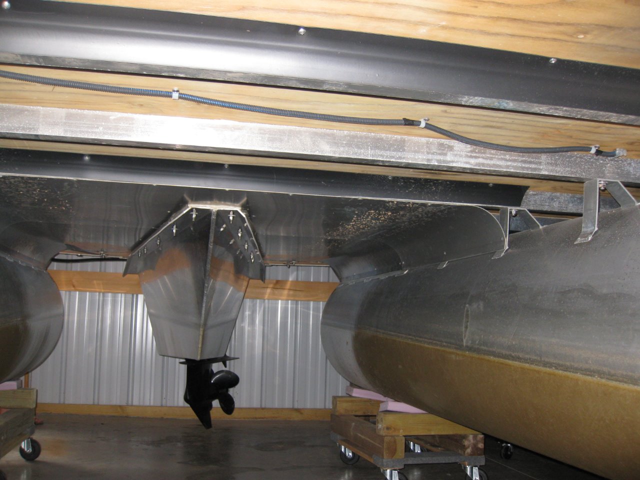

Capt Sully wrote:Dont forget to send pics :pics
Well, heres a before pic where I will need to slot the radius from the Southbay sheet so I can over lap and one of a full shot for the before and after comparison. Never noticed the black deflector before, at least I guess thats what they are . But not on every cross member. I will get some after as well.
