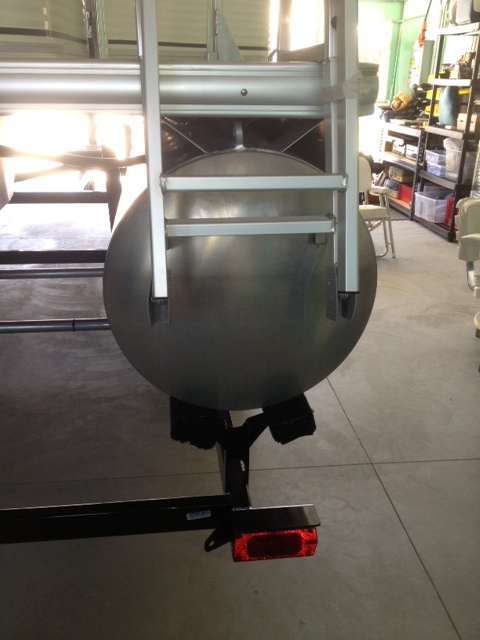

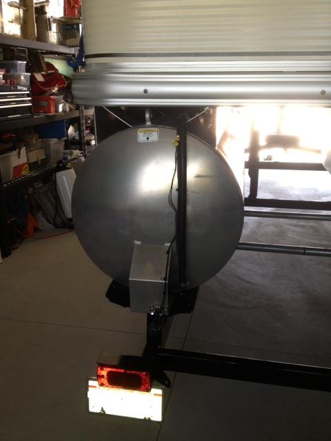

Hello Ladies and Gents--
I was wondering.... how many of you use stern tie downs on your toons?
My toon, as I'm sure most do, has a heavy tab/ring welded at the top stern of each pontoon. My trailer also has a welded tab with a hole to attach a tie down.
I would like to use tie downs at stern (previous owner did not) on both pontoons, but the port pontoon has a bracket welded at bottom of pontoon to attach live well pump and transducer. It is basically in the way and blocks the path of my proposed tie down. Starboard toon appears to have a clear path between the two rings/tabs, other than the strap rubbing against rear part of toon (see pics).
Any of have this dilemma and how did you solve?
Pics of your stern tie downs would be great!!
Thanks

Your set-up is exactly like mine. I just put the strap along the outboard side of the transducer mount, with a chunk of split garden hose on the sharp edge to prevent it wearing the strap.
