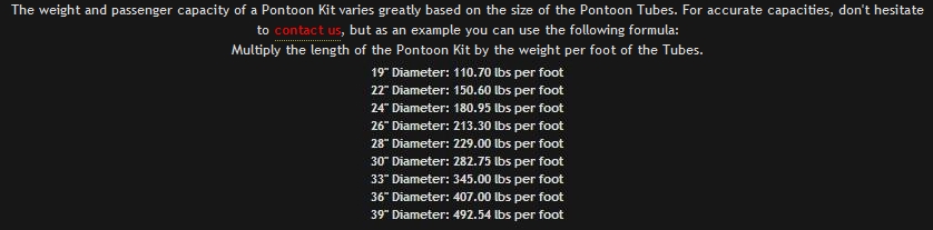

Mounting it lower won't do anything, sorry. Once you are submerged past the diameter (in your case 9.5 inches under the water) you don't gain buoyancy, and in fact the additional weight and drag created by the water now sitting on top of the log will slow you down.
Buoyancy is determined by the width of the log, ie; the amount of water it displaces. You'll certainly gain buoyancy just by mounting an additional log, but there is a weight and drag penalty to pay that may overwhelm your current motor.
When you see new boats with larger diameter center logs the idea is to allow the boat to turn quicker since it forms more of a V shape on plane and tends to lean into the direction you turn.
Here's a good reference chart to get a ballpark idea of how much you can expect to gain:
toon diameters and weight.jpg (86.97 KiB) Viewed 1451 times

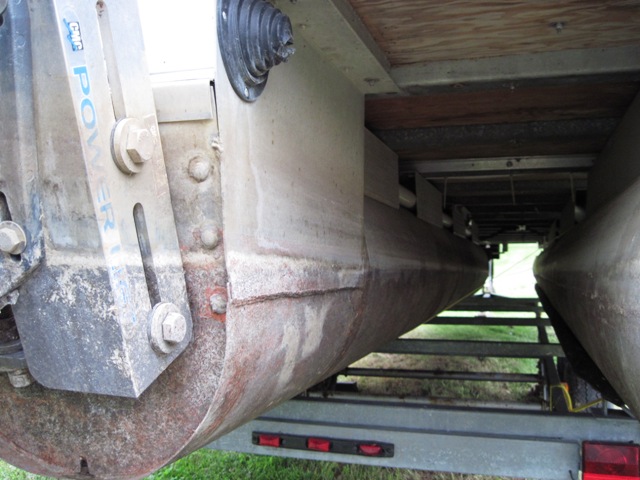

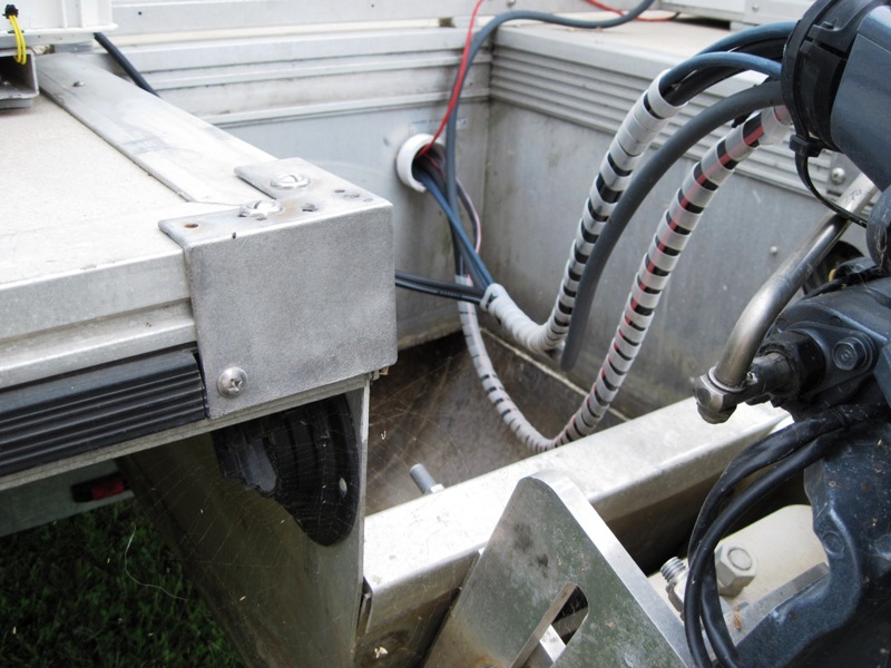

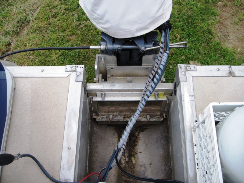

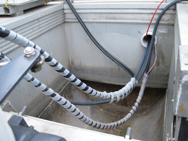

If you have the skills I'm sure it can be done and you could actually pull it off. First you would need to carefully cut off the endcap on the tube, note you will likely re-weld and reuse it as a plug in front of your fabricated transom. Now you need to determine the depth needed for your new transom. Now mark you pontoon something like this: T . Cut the short end of the T down to center and the long end from the back to the short end cut. Now bend both sides straight up to form the sides of your motor transom. Now take the previously cut off end-cap carefully cut and grind as necessary to neatly fit back inside the pontoon and weld it into place, you have now resealed the pontoon. Now on to the rest of the fabrication and hopefully I can explain this in photo's..
Inside rear view of transom
Well anyway I hope you can see enough angles from the photo's to see how you could pull this off. I may have a couple of more that may be helpful but they'd need to be re-sized for posting here.

That's what I was looking for. How do like it ?
