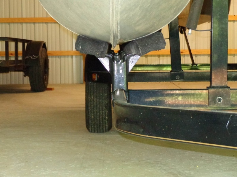

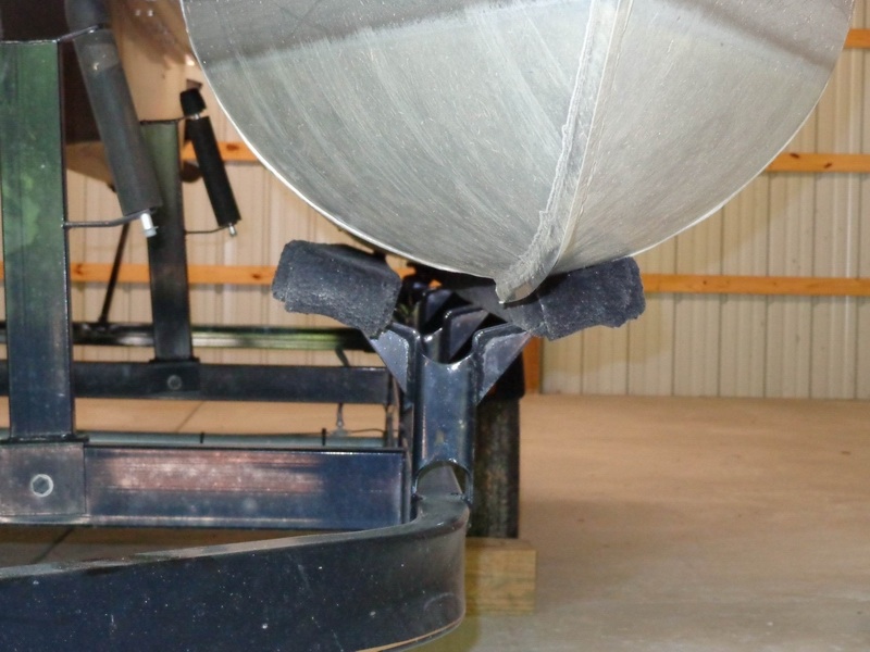

Pulled the new toon out of the water to install FF and took a good look at how the boat sits on the trailer. To my surprise, the two toons don't sit squarely on their bunks. In the pics:
1. Starboard toon sits squarely on the bunk
2. Port toon sits on the outer bunk only, leaving a gap between the toon and the inner bunk.
We don't trailer the toon except to the slip. If I ever need to go some distance, should I get the bunks fitted correctly first? In its present state, even super-tied to the trailer, it strikes me as a potential disaster. Am I okay or am I just 'sessing about it?

I haven't seen that before but agree is a problem.
Just want to say I had those roller guides when I first got my boat/trailer and it was always hell to load.
I took those rollers off and replaced them with 2x6 carpeted boards and it made loading much easier

Those carpeted bunk boards are perfectly centered above the frame rails. It looks like a 8' 6" boat sitting on a 8' wide trailer.
I agree about doing away with the roller inside trailer guides and going with the carpeted boards a little closer to the toons.
Other than tying down the rear and front ends of the boat to the frame, I don't know what can be done. People run every day with pontoon boats crooked on the trailer. If you're going just a short distance, you're probably okay.

I agree with Bamaman, the boat is too wide for the trailer. How long have you had the boat, and did it come with the trailer? You may need to either get a new trailer, or have your current trailer modified so the bunks sit about 3-4 inches further out from the trailer frame rails. I don't see in your pictures how you're going to be able to widen the bunks very easy. My trailer, it would be really easy, but that doesn't help you much.

+1Bamaman wrote:Those carpeted bunk boards are perfectly centered above the frame rails. It looks like a 8' 6" boat sitting on a 8' wide trailer.

Right now ALL the weight is riding on the outside bunk and if it fails going over a bump you have a high probablity of gouging your log with the metal supports.
I would shim the inside bunk on the left side higher - so that the log is riding on both bunks - to distribute the weight more evenly.
