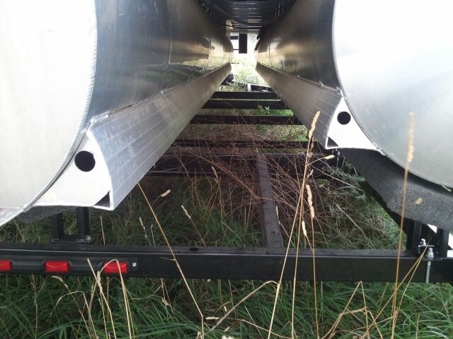

Forset River now makes the South Bay, Etc lines. Their strakes are extruded and have a slight cup to the bottom and side, so I doubt you could replicate them:
- 2012-09-18 14.11.44.jpg (59.72 KiB) Viewed 7520 times

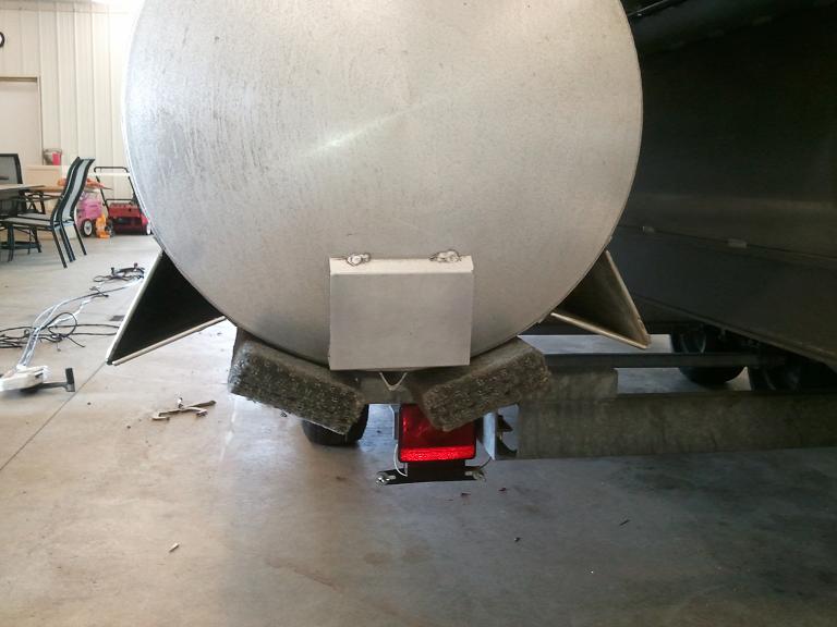

This is a Bennington tube that had factory inside strakes, and I added the outside strakes. This boat would run a solid 40 on good water with an old school 83 Johnson 140:
- 2011-05-29 11.09.57.jpg (55.18 KiB) Viewed 7519 times

Thanks for the pics/info! How long was the bennington that you put the outside strakes on? The placement on those strakes is about what i would do. I have 2x6 bunks and i'd have to redo my whole trailer brackets and bunks to put the strakes on any lower. In either case i may have to unbolt my bunks and move them inward an inch or two to fit the strakes.ToonGuy wrote:This is a Bennington tube that had factory inside strakes, and I added the outside strakes. This boat would run a solid 40 on good water with an old school 83 Johnson 140:
