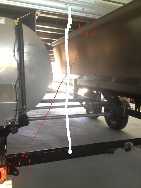

Hello-
In a previous post I asked how many used stern tie downs and found most of you do. I want to add them to my toon/trailer. I purchased the retractable transom BoatBuckles. They appear to be a good product and work slick!
I need a point of attachment on both the boat and trailer. In order to get a straight run from my retractable BoatBuckle to the boat, I need to add a U bolt. In my previous post, someone added a U bolt added to the rear section aluminum rub rail. This would be a perfect spot, as it is directly below the rear cross member of the trailer (where the BoatBuckle will be attached). It would allow for a completely vertical path of tie down.
1. Question....On my Tracker Fishing Barge, the rear section of rub rail attaches to a piece of angle aluminum which acts as a mounting surface for the rub rail. Neither the rub rail or angle aluminum attaches to any frame cross member. I am not sure how strong this would be for a tie down point. Is this section adequately strong enough for a tie down point? Thoughts?
NOTE: I have attached a pic showing the new path I am considering. The red line was old path and the white line is NEW path.
Thanks!
2. Trailer attachment....I can either drill 7/16" holes (2 holes for two tie downs) in rear cross member of trailer and attach BoatBuckle to cross member OR fabricate a flat bracket (1" wide x 7"-8" long X 3/16" thick) that is attached with a 3" square U bolt to cross member. I would drill a 7/16" hole at top of the flat bracket and attach BoatBuckle here. Why the bracket? To avoid a hole in trailer cross member which could weaken that section of cross member? I'd love to just drill a hole in cross member but I am concerned with that large of a hole in a 3" cross member that is not that thick to begin with (Trailstar Trailer). Thoughts?
Thoughts?
Thanks!
Thoughts?
- transom tie downs.JPG (35.18 KiB) Viewed 2655 times
2011 Keystone Outback 250RS

I checked mine and at first thought it connected to frame, but upon closer inspection, it is a C channel piece of aluminum that runs across stern and rub rail attached to this flat part of C channel. The C channel only is attached to rub rail, not to frame/cross members.
I wonder if my first idea is better.....use an eye bolt in place of the last engine pod bolt....(engine pod is through bolted to cross members)....i was thinking of replacing the last bolt (closest to stern) with an eye bolt and using this as my stern tie down connection point.
See bolt at top of red line (attached pic)
Thanks for all input
- transom tie downs.JPG (35.18 KiB) Viewed 2480 times

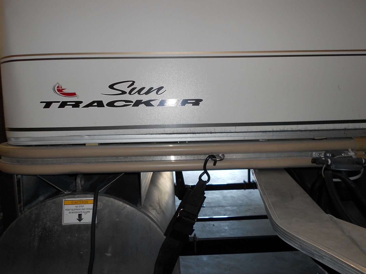

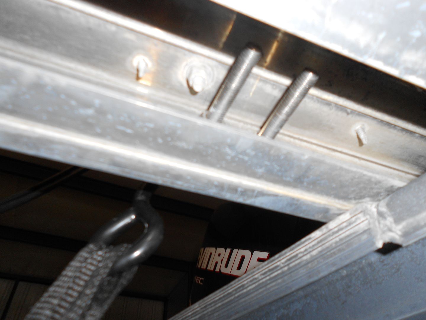

Re: Is adding a U bolt to stern rub rail section a good idea?
SoCalAngler
- Posts: 140
Lloyd...Thanks for the detailed pic. Yours is a little different than mine. My C channel is butted up against a cross member, but is not welded to it. I'm a little concerned about the strength of rub rail as an attachment point for a tie down. I may have to consider using an eye bolt to replace the rear most engine pod bolt (one on each side).
SoCalAngler
- Posts: 140
Thanks Lloyd....that eye bolt looks like a great idea. I've decided to add the eye bolt to my rub rail just as yours. I believe it should be plenty strong. I'm also going to add the Boat Buckles in the corners of the trailer (near tail lights) off the factory tabs. Should make tying off the stern a breeze!
