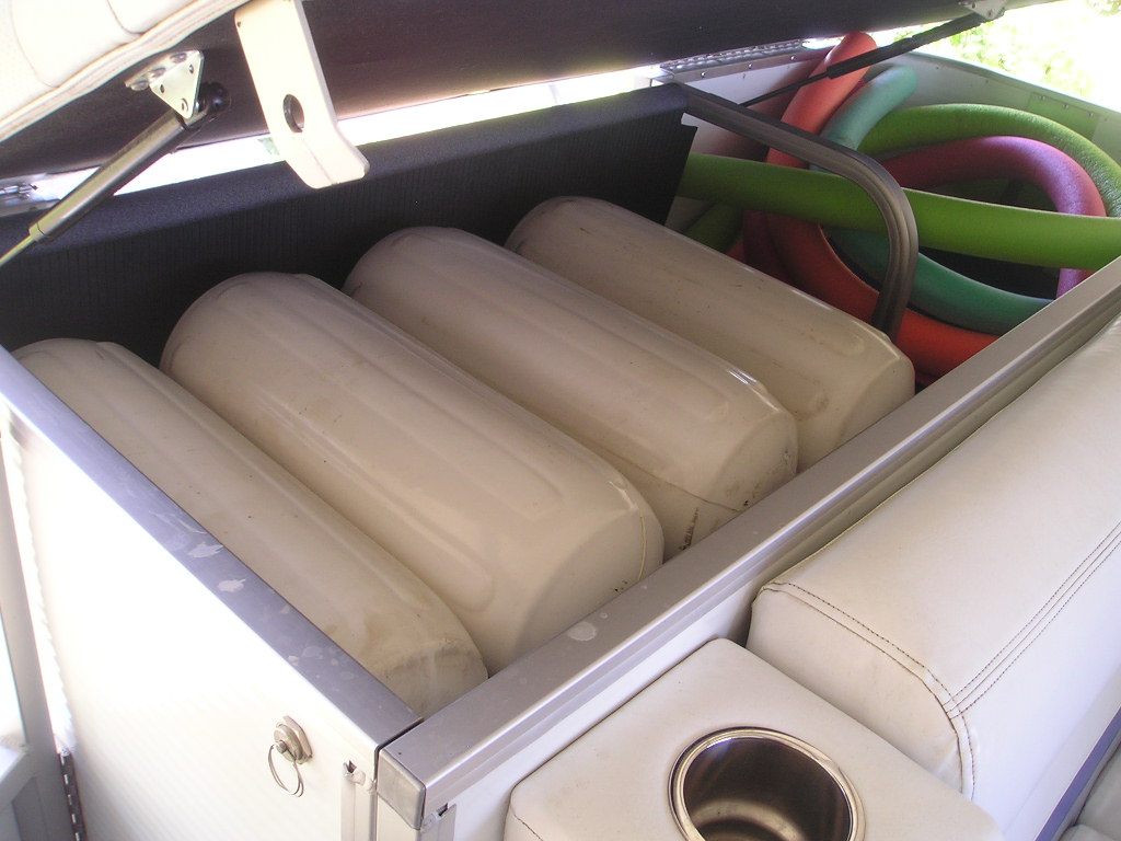

Can't really see how I put it together, but this is what I made out of some extra railings I had from Manitou when I was playing with different ideas. This was open wasted space before I added the toybox under the rear sunpad. In 2009 this was incorporated into the new design with a molded plastic liner. Transom and interior changes were all made. New graphics made the 2010 XPlode look KILLER!

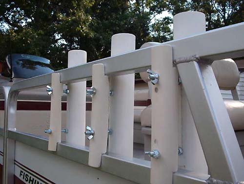

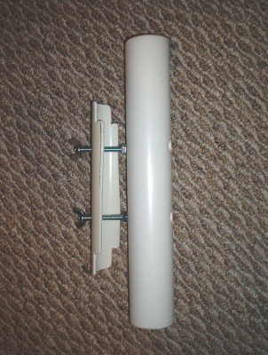

I've seen them made a few times but don't have any photo's I've taken myself. Here's a few photo's stolen from a catfishing forum that should provide a general idea of the principal...redbeard wrote:What kind of fittings? Tee's at the bottom? I had thought of making my own just couldn't find the right fittings to make them.
Here's the post the photo's came from:
I can already visualize some changes.... creativity can sometimes provide better solutions than anything available commercially..Made some holders for the toon. Not really for holding rods while fishing, but more for keeping the net and rods that are not being used at the time up off the floor and out of the way. I wanted something that would not involve drilling holes in my rails anywhere and heres what I came up with.
Took 2 pieces of 1.5 in pvc about a foot long and drilled the usual holes in em. Then I split one down the middle and held it up to the side rails on my toon to mark the spots to notch it out. The notches in the split half prevent up/down/side movement once the wingnuts get tightened down. The holders clamp onto the side rails with the split half to the outside. All I have to do to move one is losen the wingnuts a bit and slide it to where I want it. I've made three so far and have enough materials for 3 or 4 more if I need em.

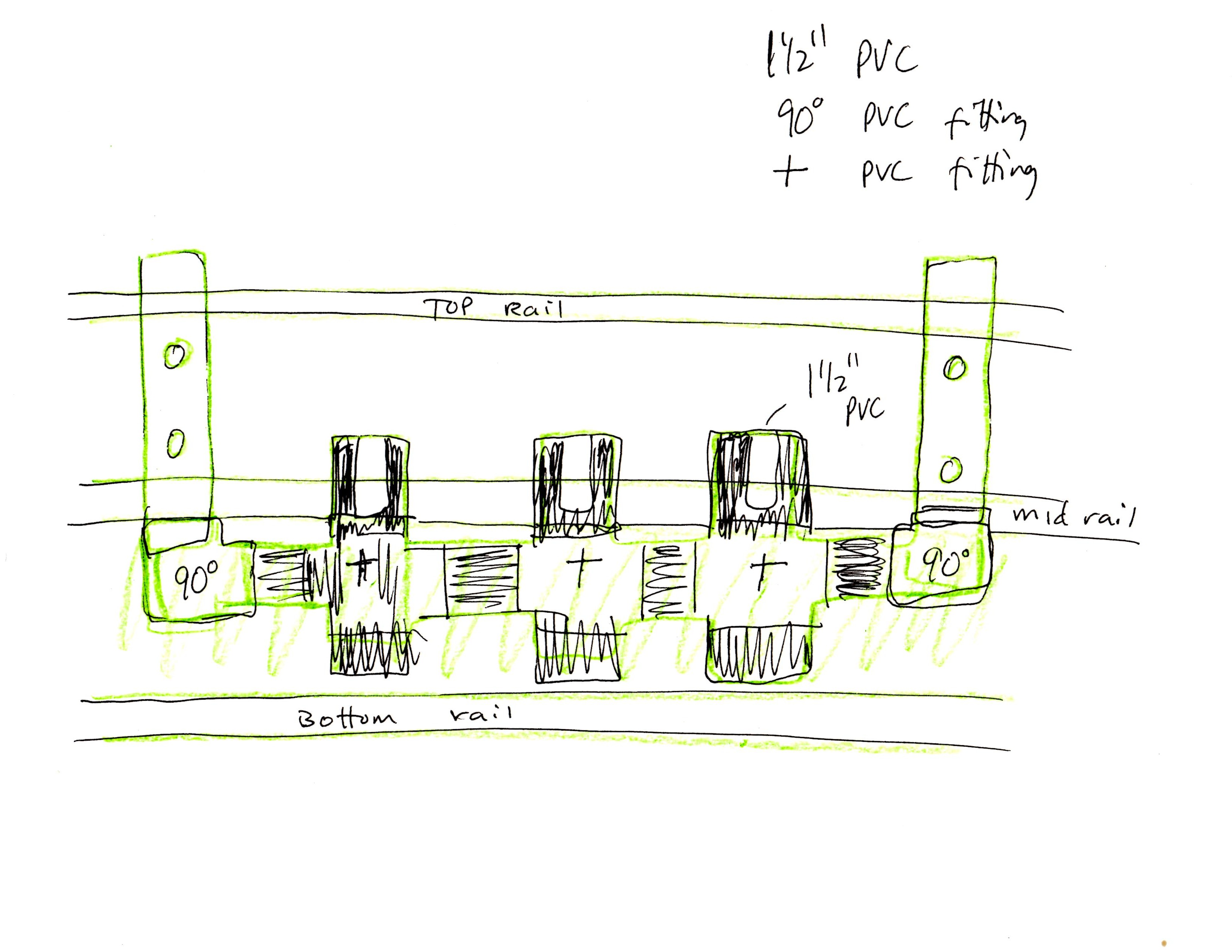

I created a sketch of one way the rods can be brought closer to deck (my preference). I'm no artist, but I think you can get the gist of my contraption!
Cake and eat it too!
I get my rods stored vertically, no holes drilled in my railings, and on the cheap to boot!!
- rod holder sketch 2.jpg (623.33 KiB) Viewed 2965 times
