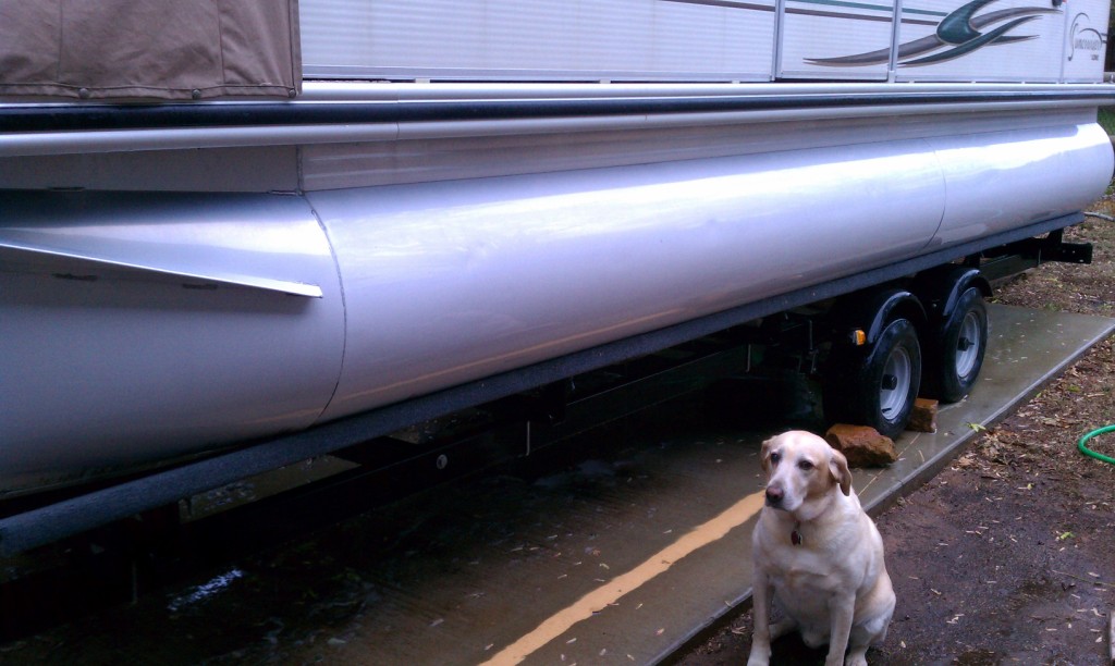

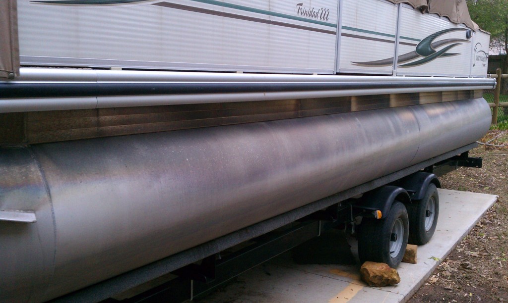

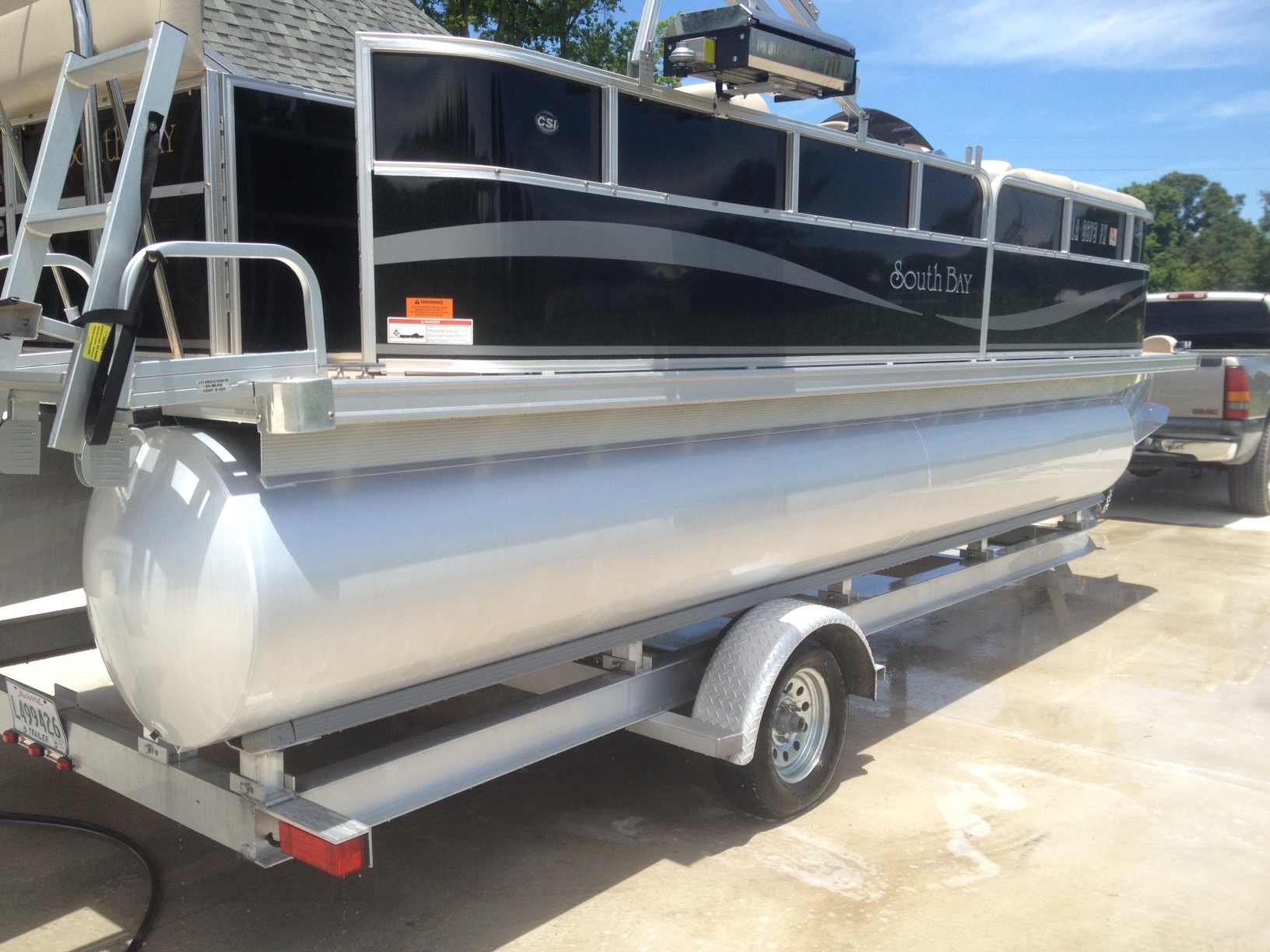

I don't think it has ever been determined if the gallon sized stuff is diluted from what they sell in the squirt bottles. I bought 2 of the squirt bottles and used them on our toons. It took 2 treatments but it did a great job. Just wet the toons down then spray the cleaner, let it set for 5 minutes and then hose it off -- then repeat. If you don't have much wind, you might want to get a respirator of some kind because the fumes are very strong on this cleaner.
Before
After

OK Toon wrote:I don't think it has ever been determined if the gallon sized stuff is diluted from what they sell in the squirt bottles. I bought 2 of the squirt bottles and used them on our toons. It took 2 treatments but it did a great job. Just wet the toons down then spray the cleaner, let it set for 5 minutes and then hose it off -- then repeat. If you don't have much wind, you might want to get a respirator of some kind because the fumes are very strong on this cleaner.
What product did you use here?
OK Toon
Posts: 627
Location: Broken Arrow, OK
Re: Tube cleaning tricks?
#6 Post by OK Toon » Mon Jun 03, 2013 10:53 am
Lightpants, I used the Napa Aluminumn Brightener. But my local Napa only carried the squirt bottles and not the gallon jug. This will be part of my yearly maintenance from now on -- this was the first time I used this stuff and I was very amazed.

I give the Napa aluminum brightener the big thumbs up. Previously, I used other stuff and a lot of elbow grease with little effect. I mixed the napa stuff half and half with water in a spray bottle (okay; the girlfriend did) and just sprayed it on, waited a minute or two and sprayed it off with a hose. It was amazing. On the really tough spots, I reapplied, scrubbed (not much effort) with a scotchbrite pad, and rinsed. Can't believe the result.

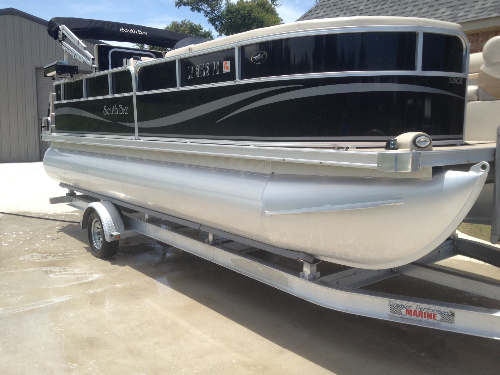

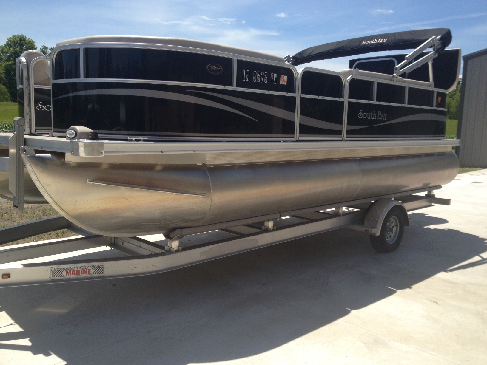

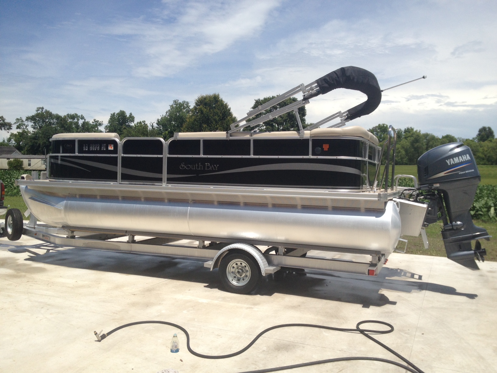

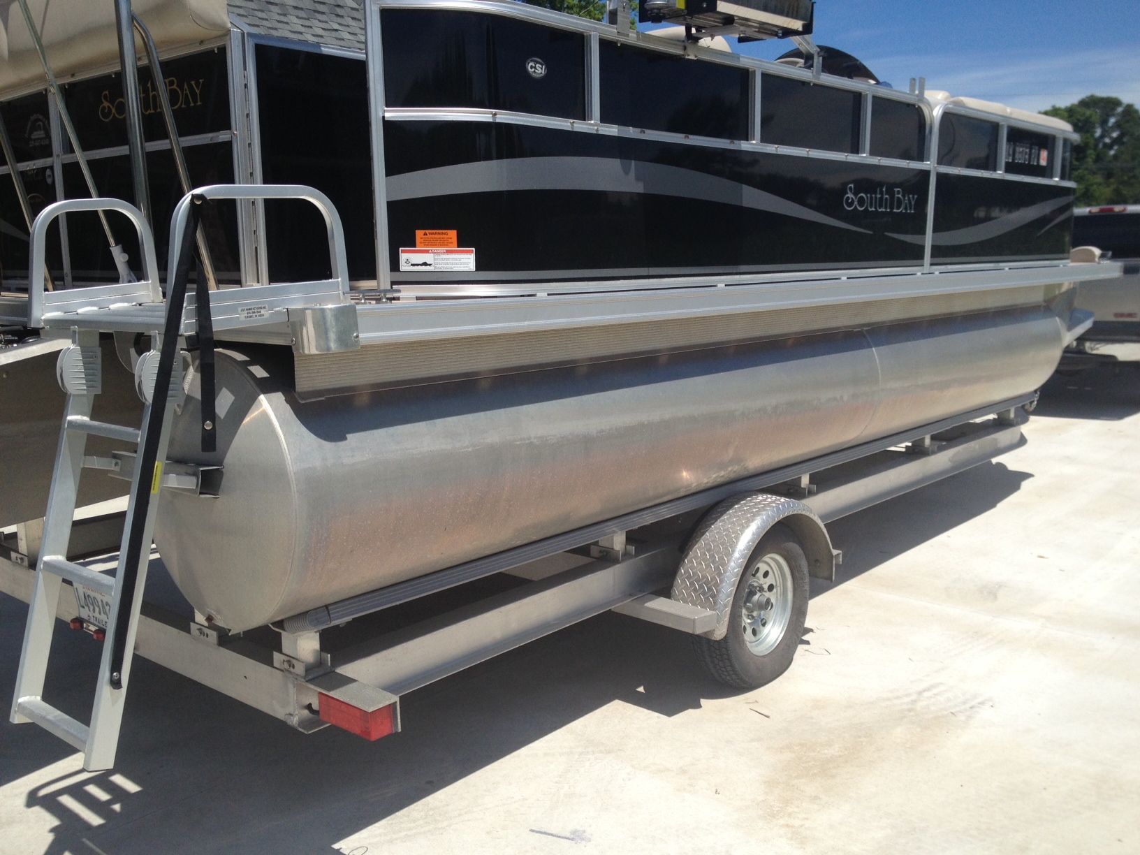

I applied NAPA Aluma-Brite mixed 1 to 1 with water in a garden sprayer this weekend and the results are indeed amazing. The Best ten bucks I ever spent.
