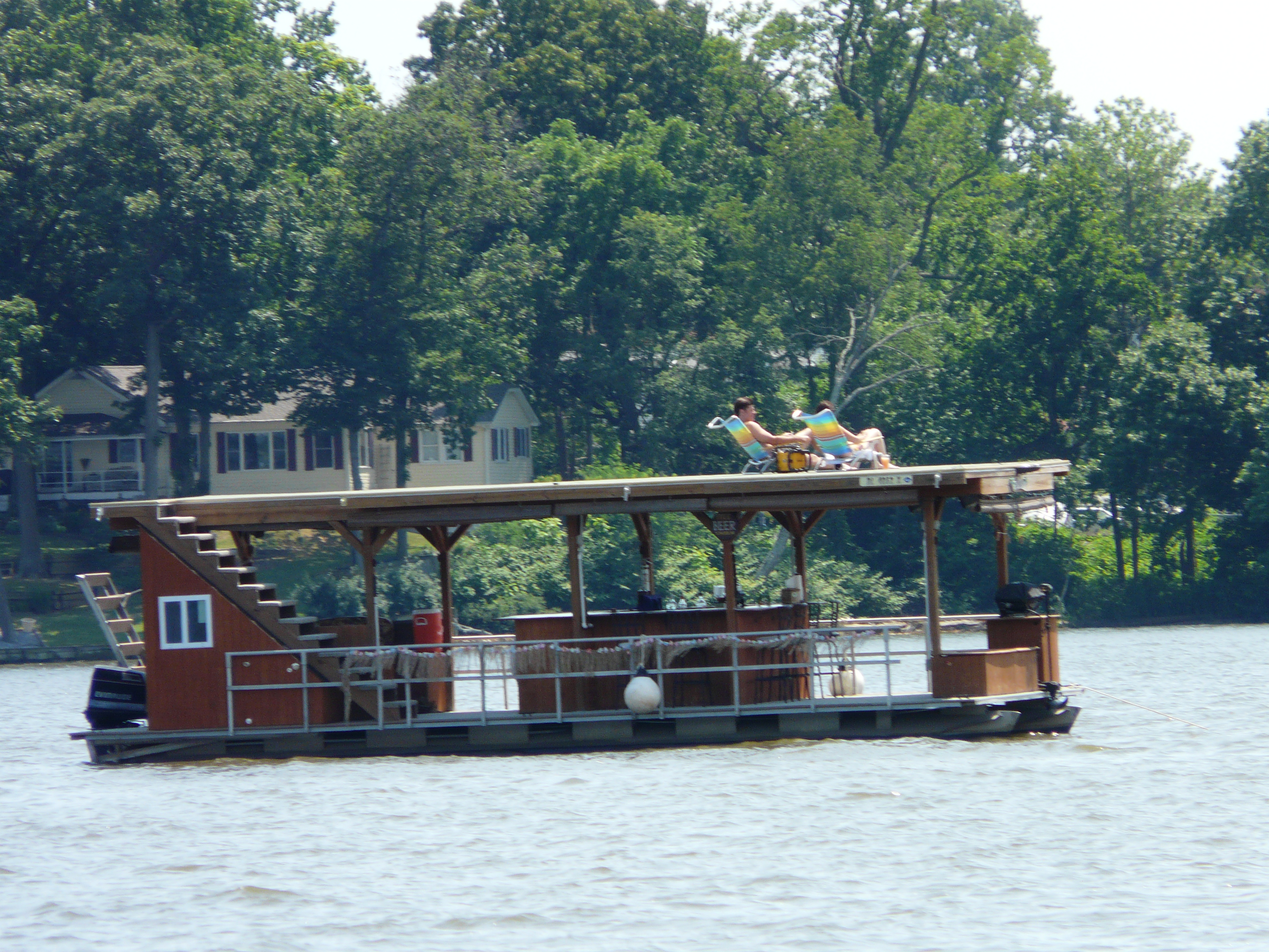

Some advise:
Use what Sun Tracker does for the party Cruisers, that being the only plywood is the cabin roof. Use all aluminum structural, and laminated foam composite board for the cabin sides.
Don't do what this guy did. It flipped over last year in a storm and his wife was trapped under it, but was pulled out in time:

Holy crap!!! How was he able to keep that thing in the water????badmoonrising wrote:Some advise:
Dave

That thing is so heavy the logs were almost submerged. Our marina didn't want him in a slip there at first. He went to another marina and one day last year he took it out in windy conditions and it flipped.evinrude2stroke wrote: Holy crap!!! How was he able to keep that thing in the water????
His marina uprighted it and thye were back out on it 2 weeks later.
Original it was a house boat with aluminum cabin...then he added all that heavy wood
Haven't been out yet this year so I don't know if he's still on the river with it.
