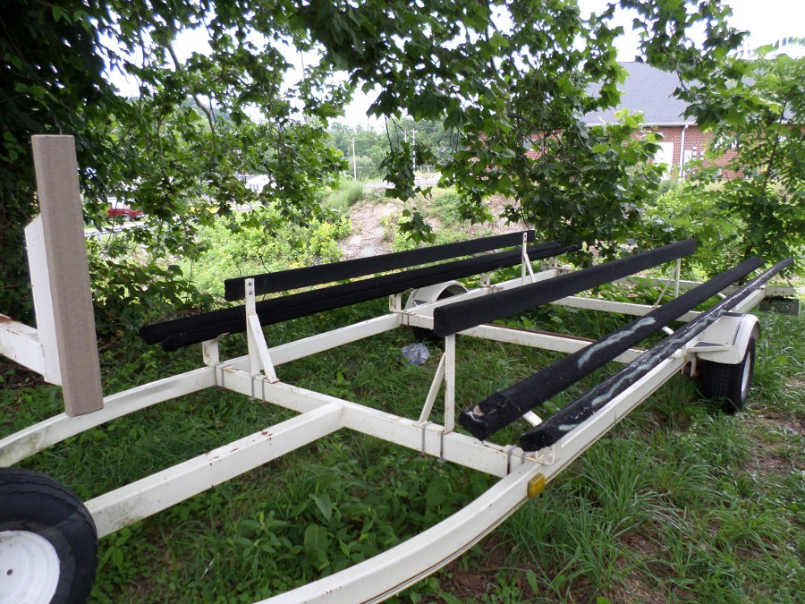

A common spot for the main power fuse is at the battery, And this is the type of glides that work and hold up year after year. Ignore the stripes down the bunks grand son decided I needed some chalk on them lol .

Yeah I found the main 30 amp fuse from the battery blown. We had a small inverter to power an air pump for the tube...and I believe that is what blew the fuse. Got that problem fixed. As for the guide supports, I welded up a set like the ones James pictured for my previous pontoon trailer and they never waivered. I got the tubing and wire welder to fix that as well. Also my guides are too short. I like the longer boards on your guides much better. I guarantee they will hold the boat straight when I get done with them.
