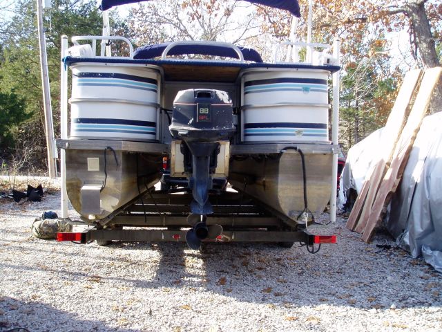

Well the boat is a 25 footer,
and even with just two people and half a tank of gas its slowwww.... The motor is 1986 88spl rated at 90 horse. Not sure what the prop is, but at WOT it turning 5500 and only going about 15 mph.. Seems to be running alright. and I only run the non ethenol fuel in it. The motor looks brand new under the cowl, so I figure the past owners must have had it serviced regular. Mabey the prop is just wrong

The motor looks to be sitting in the transom a bit low.does it have adjustment holes to change motor height? If it does, try raising it a bit. Some older motors were rated very optimistically, not saying this is the case, but,,,,the motor may not be laying down what it claims. Without knowing what the design peak HP RPM is, we are shooting in the dark. 5500 sounds low. Motor may be sitting too low, prop may be too heavy of a pitch, or its just not a real strong motor. A new rated 60 will get you 17-18 mph for comparison on a boat that size. Also if you measure the deck on that boat, it's probably about 22 feet long. Some boats seem shorter than others because the manufacturer measure them from different reference points. Apples to apples I would say that boat assimilates a 22 footer. It's just got a long transom. My old Bennington was the same way.

22 feet. Inside of the playpen and 25 feet from deck to deck, and I noticed that the motor seems to be a little low in the water. When at full speed and even trim the water is almost up to to bottom of the actual motor its self. I usually trim it up a little to keep the water from coming up over the transom itself. How much does that make a difference. I'll try to get a picture of it this week.

Your RPM are right on the money per service manual 4500-5500 RPM WOT but it sounds like the motor is setting to low, you want the cavitation plate to be just under water while under way at WOT. Oh BTW this motor is a gas pig IMO.
Re: Speed of boat seems a little slow
Yes it does like to drink deeply when at WOT.. I bet somewhere in the range of about 2 miles per gallon or less.. lol.. It does have holes for moving the motor up I beleive.. Now to see how to get it out of the water to move the motor and try it. Cant Hurt to try.. The plate is under water at wot, like probably several inches.

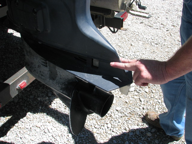

readbeard, can you get me a picture of what it looks like where your motor is setting just for a comparison, we have a pretty similar setup.

Been looking for pic of what you wanted let me know if these help, I've been working on a full set of pic's so I have them on hand but the boat is 120 miles away maybe some day I'll have them all.
- This is where the water level is at WOT

Thanks Man that helps alot.. I will look this weekend and snap some pics to see where mine is at.. I am sure its alot higher than that.. I may have to see if I can get someone with a trailor to come get it out of the water so I can lift the motor a couple of holes and see how it goes.
