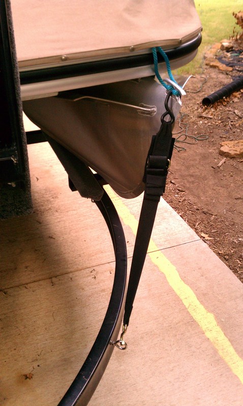

Most Trackers have something like this. You need a strap or chain! Especially if you are towing the winch straps will break. I am on my third one in 5 years!

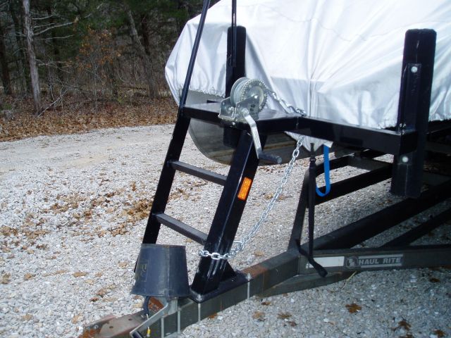

I use a chain. This is not the best pic of my setup but its all I have to show you of my setup. When I'm on the road both the chain and strap are in the same eye bolt, makes for my 4 tie down points. When its parked they are undone so that I can tie down the cover.

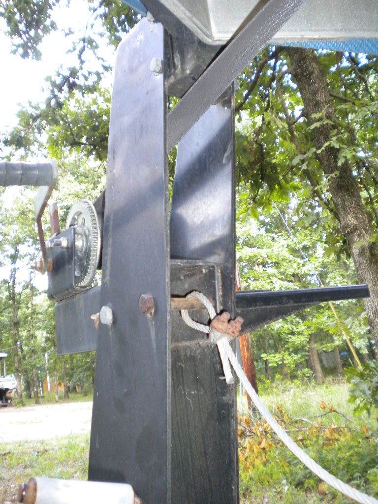

We have a place about 100 yards from the boat ramp. If I'm just towing it back to our lake place, I use the winch strap and I use a chain similar to Redbeard (I just use an anchor chain that has the plastic coating and I put a snap hook on the end). This will keep the boat from sliding back off the trailer if the winch strap were to break.
When we tow it longer distance, I added a couple of eye bolts to the trailer frame. I then use 2" transom straps to secure the front of the boat from bouncing -- this set up makes the boat ride rock solid on the trailer.
