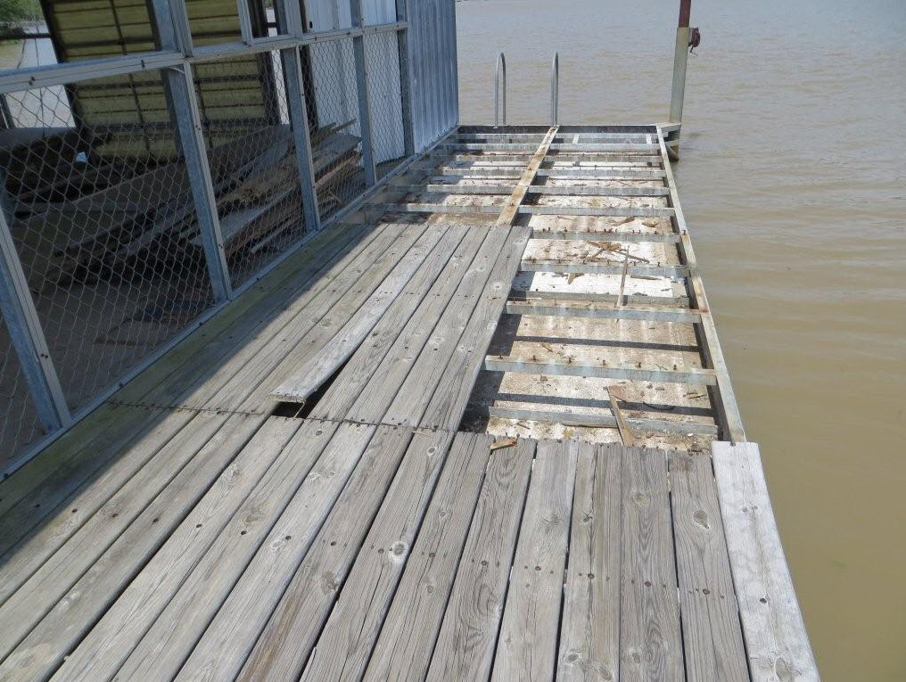

Just a few pics of the work we've been doing on our boat dock. I had replaced the plywood on the swim side of our dock about 10 years ago. I only used regular decking boards which did not hold up to the elements and the steel floor joists -- the ends of the boards would bust the screw heads and start getting all warped.
So, it was time to pull it all off and do something better.
All of the old decking boards being removed. You can see one of the boards that popped up on the end.
dock repair 1.jpg (188.02 KiB) Viewed 1019 times

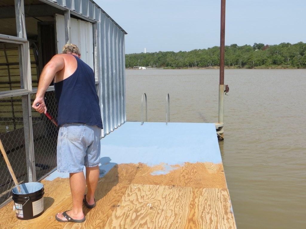

First coat of Rustoleum Restore being applied.
Dock - 1st coat of Restore.jpg (102.91 KiB) Viewed 1019 times

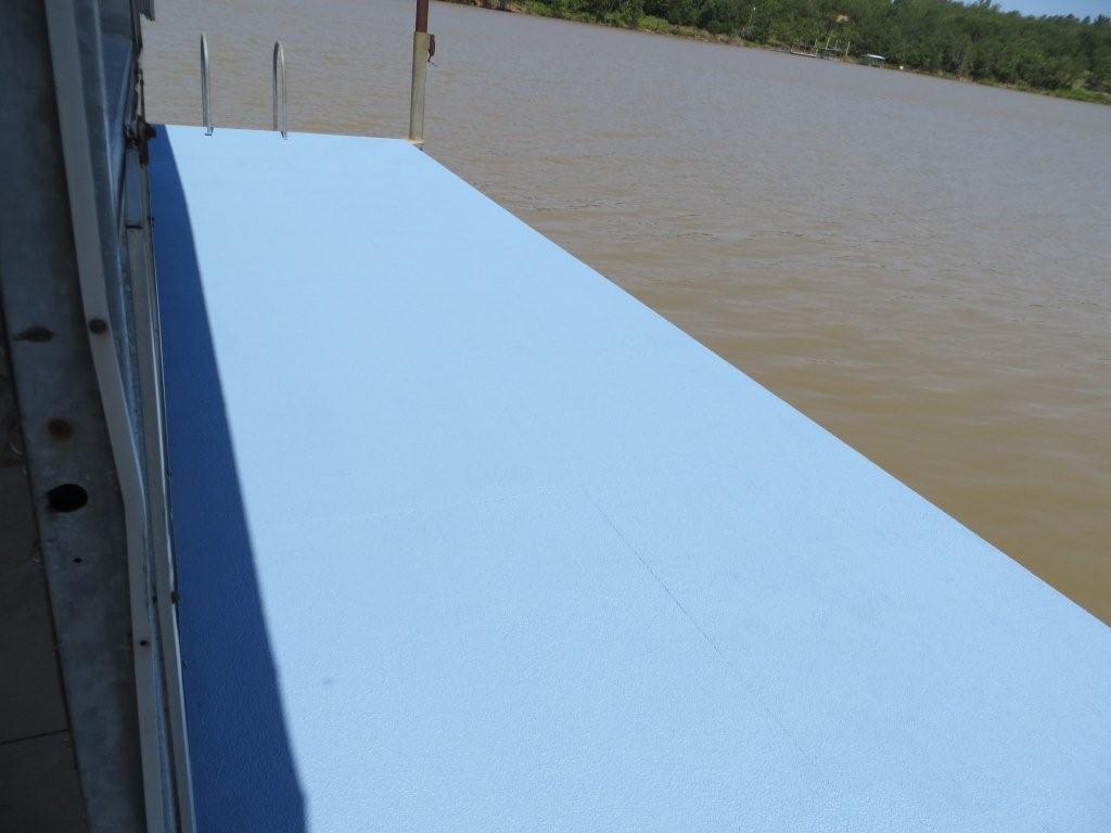

Here is what it looks like after the 2nd coat. It's hard to see, but it has a nice non-slip texture.
Dock - 2nd coat of Restore.jpg (61.34 KiB) Viewed 1019 times

#3 Post by OK Toon » Tue Jun 25, 2013 1:54 pm
It's not slippery. It's hard to tell in the pics, but there is a texture like you might see around a swimming pool. The stuff is called Restore -- http://rustoleumrestore.com/
