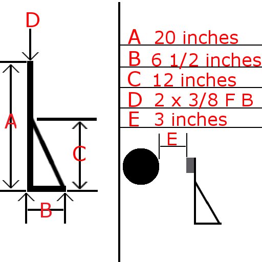

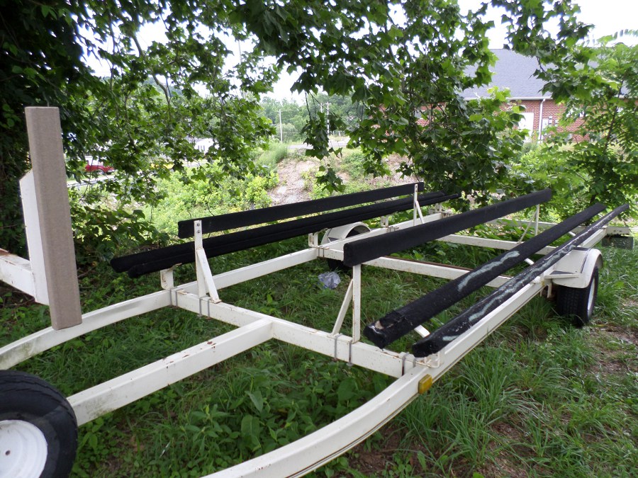

This will solve the problem.
- gides 900.JPG (264.81 KiB) Viewed 9586 times
- brace jpg.jpg (34.47 KiB) Viewed 9595 times

I made something just like this and it works GREAT!
Crosswind doesn't bother this at all. In fact its better to come at the trailer a bit to the side so the guides can guide the boat onto the trailer.
I don't have time to search through all my pics this morning, if you want to see more I'll get them this evening, but hopefully you can make out what I did.
This is when I was working out the kinks, i since added a 2x4 brace on the end, and a longer 2x4 about two feet inside two helps with impacts.
Also of course carpeted all exposed wood, I wish I had current pics, it doesn't look as rough as when I was working things out.
This has made loading EASY!
This is for a two log toon though.
Once you pass the first part of the guide boards just give it a bit of power and you are on straight the first time every time.

Thank you for those pics Steve. That is more like what I want to build for my trailer. Your design is much like the 4c product, only simpler and cheaper. I am going to fab up something like that too.

Steve, from the pics, it doesn't look like you raised the rear portion of the guides to allow for the angle of the loading ramp. Isn't most of the guiding portion of your design underwater as you approach the trailer?
Re: Loading onto a trailer in a crosswind
Yes Sir correct I did not raise it any-fiddlebick wrote:Steve, from the pics, it doesn't look like you raised the rear portion of the guides to allow for the angle of the loading ramp. Isn't most of the guiding portion of your design underwater as you approach the trailer?
I put the white hard vinyl 1x4's on top of my bunk boards and treated them with a water resistant silicone similar to "liquid rollers" So the boat slides on and off very easy-
I generally only back down till the top of the guide boards are showing and that has always been enough in any ramp I have loaded onto so far-and I have used this on several different ramps.

Ahh I see.....love it.
