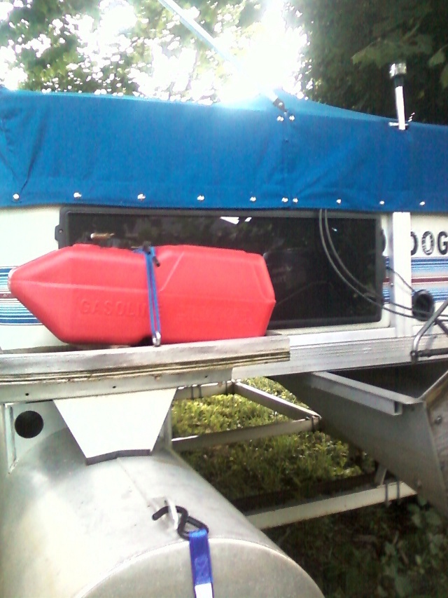

I mounted mine on a back fence panel, its not the best place because a tank is in front of a part of it but it should work. If it works ok I will make some mounts and move it up higher.
EDIT I got a pic just because

This may be a dumb question, but aren't you getting significantly less than 15w from it since its mounted vertically instead of facing somewhat toward the sun?MH Hawker wrote:I mounted mine on a back fence panel, its not the best place because a tank is in front of a part of it but it should work. If it works ok I will make some mounts and move it up higher.

This is sort of experimental. My small little 15 hp motor only has a 4 amp max charging system and I dont have 120 volts at my slip. Yes I am sure its not getting the full power but any charging it gets will be more than it gets just sitting there. Using solar panels to charge a battery on a boat are not a ideal thing due to the angle and location and so on and limited sun exposure.
I was more or less trying it out to see if it helped out before I make some mounts, Due to how my dock cover is on the boat. But it still wont be at the optimal angle and so on. Solar panels wont really do a lot as far as charging battery's but they can keep one topped off over a period of time. From the bit of research I have done a 15 watt under optimal conditions will produce 1.25 of a amp that's about what a lot of trickle chargers do. I will know a bit more tomorrow I haven't been out to the boat due to 14 days of clouds and rain.

Well after 3 nights of fishing it is keeping the battery up in good shape, not fully charged but its adding about 10 % each day, and normal use is about 15 % a night fishing trip and yes I have a meter that measures how much amps is in a battery. So I am happy with it. At night I keep the lights on, the stereo, the live well aerator, and the black light. I used to have to take it out for a 2 hour run to put 10 % back in it so it saves a good bit of gas.

From my reading: even a small amount of shading has an enormous impact on efficiency
