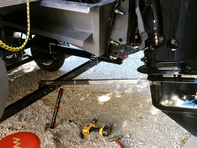

I use one, my motor is tilted up just slightly. Never had a problem with it trying to come off. Do you have a picture of your setup?
This is when I first installed mine. It's sort of homemade jobby, I found the motor side laying along the road. I fabbed the trailer side myself.
- Photo0052.jpg (97.11 KiB) Viewed 4594 times

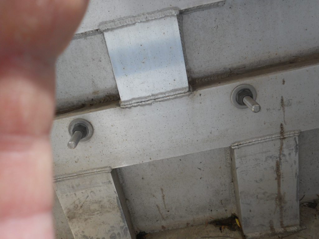

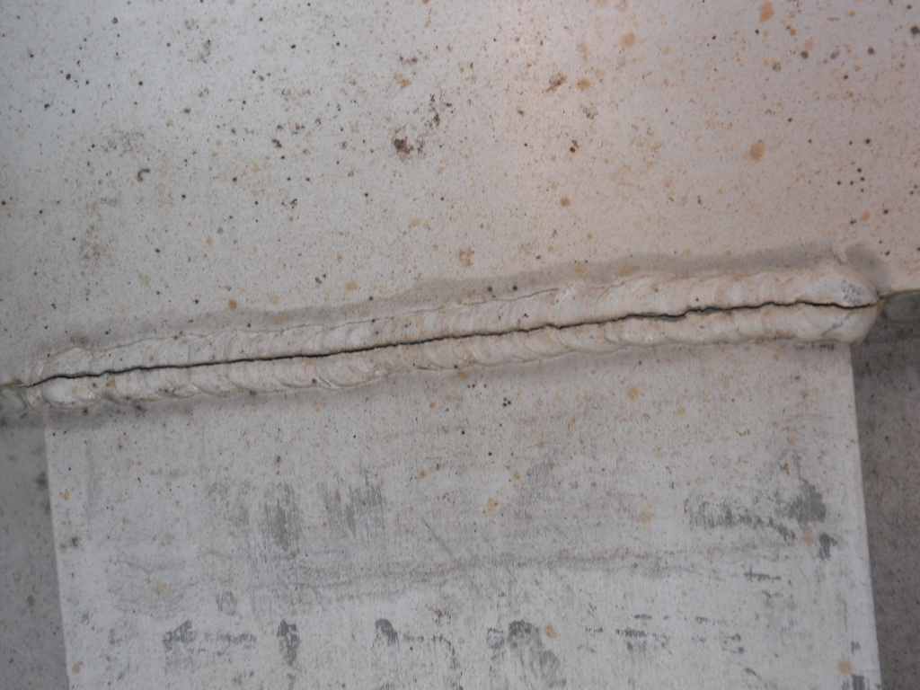

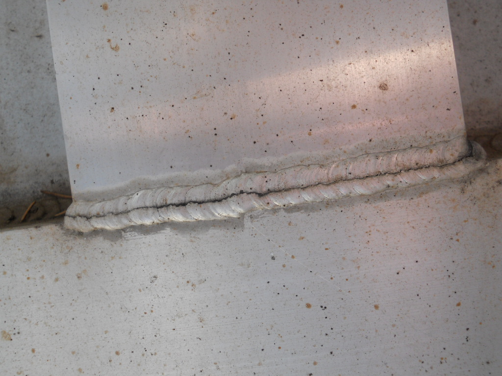

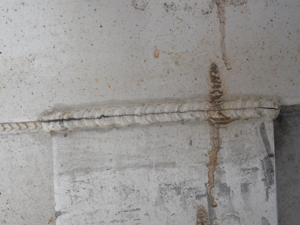

This was touched on this thread as well. viewtopic.php?f=2&t=16552 In it you'll see a picture of my transom, cracked by not using one on the way home (350 plus miles) after buying the boat. The dealer told me to use the factory Verado tow support, that swings down from the motor. I should have known better, because of all the miles logged pulling the old boat around with one, never a problem. This is not the worse that can happen. I was talking to the service manager at the repair facility that repaired the transom (free of charge, under warranty by Premiers 20 year warranty, THEY ROCK!) He said he has seen the aluminum break on the outboard side, around the bolt mounting holes where the motor bolts to the transom. Actually had a customer loose his outboard completely when his outboard mount broke around all 4 holes. I'm not sure of a smaller outboard, but mine weighs 625 pounds and when its twisting on the transom for 350 miles, somethings gonna give, eventually. I have trailered over 2100 miles in the last year with the Transom saver on this boat now. The last boat, my Manitou had over 17000 miles of trailering with one, never an issue.
My 2 cents, for under $60.00 you can have a T/Saver. Transom repair... $200.00plus and if you bust the motor bracket, $wow!
I'll use one every time I tow 1 mile or 500 miles.
Plus I can feel the difference in the tow since I brought the boat home that first trip. Its rock solid on the trailer!

kryptonite wrote:I use one, my motor is tilted up just slightly. Never had a problem with it trying to come off. Do you have a picture of your setup?
In my humble opinion, the transom saver bar is doing little to help support the weight of the motor in the above pic. In fact I will respectfully submit that there is little to no benefit from it in this pic.
Ideally, the motor should be in the highest possible position with the transom saver bar installed because a larger amount of the motors weight will be properly supported by the trailer as opposed to the transom. Think of it simple leverage terms.
I always use my TSB when on the road and think it will extend the life of many vital components like especially during the time I towed my toon from Dallas TX to KY. When its installed, my motor is practically in its upper most position.

I'll disagree, only because when I trim down against the transom saver, the transom actually goes upward slightly. So this would tell me that it does help. You're not trying to support the whole weight of the motor, just cushion it from jolts from rough roads.wrd1972 wrote:kryptonite wrote:I use one, my motor is tilted up just slightly. Never had a problem with it trying to come off. Do you have a picture of your setup?

Agreed! 100%....kryptonite wrote: I'll disagree, only because when I trim down against the transom saver, the transom actually goes upward slightly. So this would tell me that it does help. You're not trying to support the whole weight of the motor, just cushion it from jolts from rough roads.
You have to support the motor by taking the pressure off the transom and letting the trailer brace it. Take it from someone who has been there and done that. And can show you the proof.
As far as the Motormates and Lock-n-Hauls, same thing, they do not take the pressure off the transom. A buddy used a M-Y Wedge on his Champion for several years, then the transom began to spiderweb through the gelcoat. He has since gone to a trailer mounted transom saver after having his transom re-gelcoated. I used the M-Y Wedge once on my Manitou and lost it somewhere around the Iowa-Missouri border on I218-27. The trim cylinders still moved enough to loosen it up and jar it out. The trailer mounted transom saver won't let the trim cylinders move out and in, because the lower part of the outboard is locked in place.
I'm not preachin the T/Saver gospel here, but my own expirience is proof enough for myself that I'll use a trailer mounted T/Saver on everyboat I own currently and in the future.
- 529ez 004.jpg (296.45 KiB) Viewed 4122 times
- 529ez 003.jpg (295.51 KiB) Viewed 4124 times
- 529ez 002.jpg (283.59 KiB) Viewed 4126 times
- 529ez 001.jpg (280.68 KiB) Viewed 4120 times
