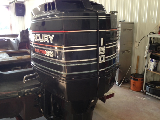

This is the first Merc I've ever owned. So when looking to order parts, I wrote down my serial number and proceeded to search the web to find out what year I had. Hmmm...not very easy to figure out with the Merc. As I looked in to this further, I realized there's a good chance some thing has been changed here....sholdn't a 2.5L of this era be a 200HP? My hood says 150...perhaps because the boat was rated for 175 max? Also, my number comes up 79-88, but my motor is Fuel Injected, and I was under the impression only Mariners were injected in that vintage? Can any of you old pros help a Merc/Mariner newb out?
Serial number 06104210

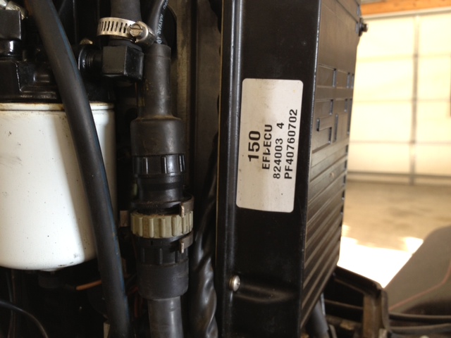

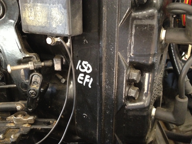

Well, I'm guessing it truly is a 150, that has been gone over and had a few things changed in the process. I see some marking under the hood that tell me it's had some parts changed over the years, perhaps the transom bracket was one of them. I'm going to guess it's the same year as the boat, a 1994.
MPosey519
Posts: 259
Re: Mercury/Mariner experts please help...
#9 Post by MPosey519 » Tue Jul 30, 2013 6:13 am
Yeah, that ECU fits model years 92-95
