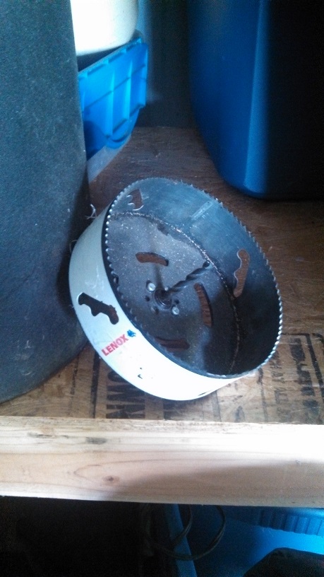

#15 Post by The_Hellbilly » Wed Aug 07, 2013 8:00 am
This is what I used. Run it forward until the drill bit makes a hole in the plastic, then run it in reverse so the teeth dont get too much bite at once. Worked perfectly. I think I paid about $40 at my local hardware store. It may seem kind of pricey, but I figured I had one shot to get it right.
hole saw.jpg (119.96 KiB) Viewed 4072 times
