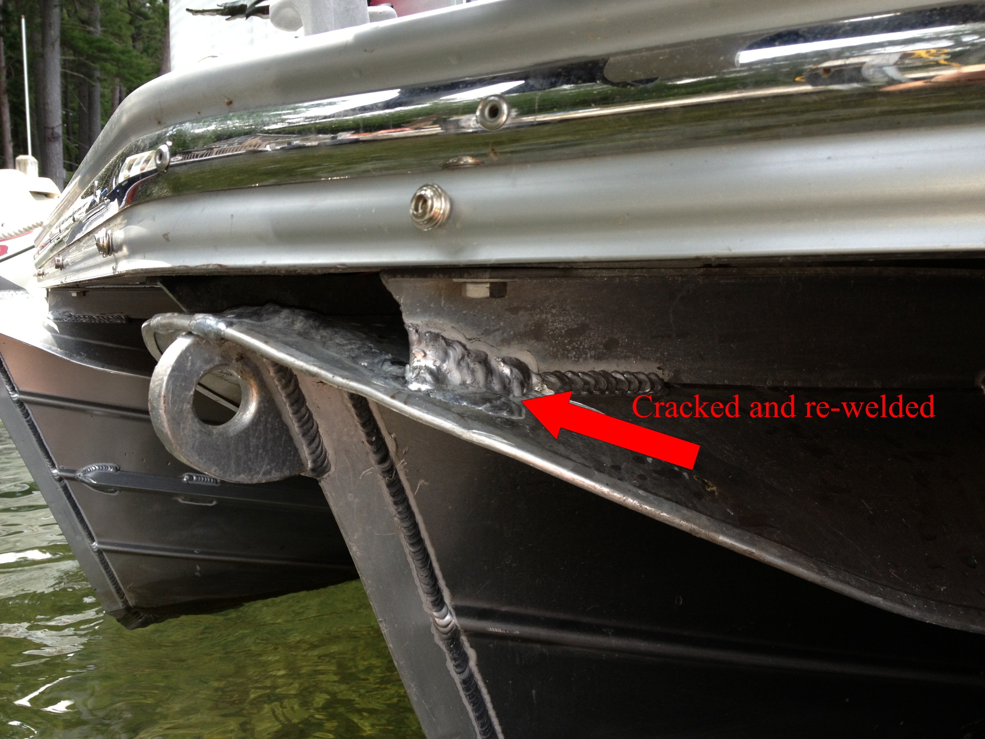

I currently own a 2008 X-Plode Cruise with a 250 H.O. Etec on it. Since I live on an island all summer, I do not have a trailer but have a slip at a reputable marina for docking my boat when traveling ashore. This same marina also stores my boat in a covered building during the winter months. The boat was purchased at a Manitou dealer who was on the same lake at that time but has since dropped Manitou as a boat line for whatever reason. I absolutely love this boat and only in the past couple summers have I been having issues.
The initial problem started occurring last spring when a couple of below waterline welds started cracking in the nosecone of the center pontoon. The front cone would completely fill with water causing dramatic performance and handling issues so it was fairly easy to tell something was wrong. Since the dealer where I bought the boat was no longer a Manitou dealer I had my marina pull the boat from the water and they immediately noticed some cracked welds right where the nosecone attaches to the main pontoon on the bottom. My Marina has a weld shop that does beautiful work so I decided to have them fix it as it seemed simple enough and I needed the boat ASAP to get back and forth to my home on the island. Two days and $600.00 later, my boat is completely repaired and the welds look great. I never contacted Manitou for warranty reimbursement as I was just happy to have the boat back on the water. I did ask my marina what they thought caused the cracking and was told they were not 100% certain but most likely weld contamination as there was evidence of gassing in the weld.
Fast forward to this spring... Same performance and handling issue is noticed. I have my Marina pull the boat to find not only more additional cracked welds on the bottom of the pontoon (same area as previously repaired but not same weld) but also this time many of the top structural welds have started to crack where the nosecone attaches to the main frame!! Now I am scared as the structural integrity of the boat has been compromised. This boat is capable of speeds exceeding 50 MPH can you imagine if the nosecone was to completely dis attach itself while going this fast with my family on board!! This would be a complete catastrophic failure with certain injury occurring!

What really irritates me is they will not even lift a finger, something as simple as sending their area rep to my marina to look at it! Instead they want me to buy a $2,000.00 trailer and pull my boat to some dealer many miles away (they lost two dealers on my lake recently!) after they tell me by email that it does not appear to be a warranty issue...why would I do that? How can continued cracking of structural welds not be their issue if the boat has never hit anything or been in an accident!??
Here is just one of the many pics of welds that were repaired I sent Manitou... This weld failed along the ENTIRE top of the nosecone!

As I stated before, we do not believe that this is a warranty issue. This is our judgment based only on the photos you provided. Certainly, we recommended that you take your boat to Northern Boats and Boards for an inspection of your center tube for a thorough inspection. You are correct that Northern Boats and Boards is no longer doing business out of their Laconia location but their Bristol location is open. You also mentioned that you do not have a trailer. Unfortunately, as stated in your owner’s manual/warranty, it is the responsibility of the retail customer to transport their boat to the dealer for warranty issues (this is true of the vast majority of pontoon manufacturers). Perhaps you could rent a trailer or have the dealer provide this service.
I understand that when this issue with the tube first arose, the dealership where you purchased the boat was no longer a Manitou dealer. Had you contacted Manitou we would have directed you to a different dealer.
After several discussions within our Research and Development team, who have more than 50 combined years of experience with pontoon boats and aluminum tubes, they came to a tentative conclusion of what may have caused the issue, that being impact. In the photos, the keel, at the junction of the nosecone and cylinder, appears crooked and "pushed into the tube". The other damage to the nosecone would be predictable based on impact damage of this nature. The two holes next to the keel are the location that many weld shops would drill holes to drain the water out of the nosecone. These would be re-welded shut after pressure testing the tube.
As mentioned, this is our tentative opinion of what may have happened. Without inspection, we cannot be certain. Manitou does strive to meet its warranty obligations in a timely manner. Our 11 consecutive CSI awards a 2 JD Power Awards are our customers affirmation of that. As you mentioned in your post we did have issues with our original design on some of the boat and engine combinations but certainly not all or a large majority of them. Although the issue caused denting in the nosecones and WAS NOT a safety issue it was a manufacturing oversight and we corrected all of the affected boats by bringing them back to our factory and installing brand new tubes with the newly designed nosecones. The new nosecones, which are installed on your boat, have never caved in the same manner as the original design.

Funny thing is in your response you admit this... "Without inspection, we cannot be certain" As to the rest of your response regarding JD Power and the rest of your advertisement, I better get my boots on as the sh&# is really starting to get deep! As far as your area dealers go, maybe you would like to tell us why you go through dealers in this area like I go through socks!
BTW as I stated to Teresa Brandt, there was no impact ever with this boat! I have never even beached it!!
