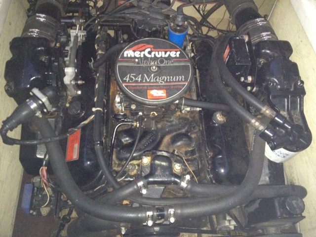

Well I should have hit Boat A up sooner...he must have needed cash bad because he sold the motor out of it last week. Since I wanted a complete boat for all the nick nacks (and ease of transport) that was out. So I made a deal on boat B. IF this project comes together, I'll leave the 454 Mag stock in hopes the Alpha drive holds up. Besides, it's only got 320 hrs on the entire boat and she purrs like a kitten

Looks familiar! Good to see it has the remote oil filter.
Have fun. Buy lots of band-aids (and beer)
