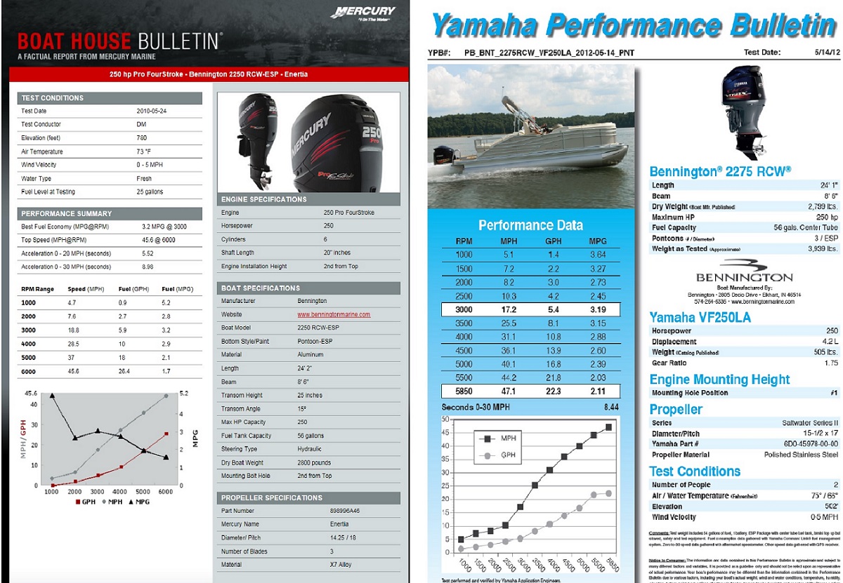

A couple of highlights from the tests:
Note the Yamaha is FULL of fuel
Yamaha is ~.5 seconds faster 0-30
Yamaha gets ~25% better fuel economy @ wot
Yamaha runs ~ 1.5 mph faster even with 29 more gallons on board.
- YamvsMerconBenn.jpg (335 KiB) Viewed 7080 times

Re: Vmax or Verado
Sorry guys and gals, trying to get the size right.

Re: Vmax or Verado
I think you got it.
