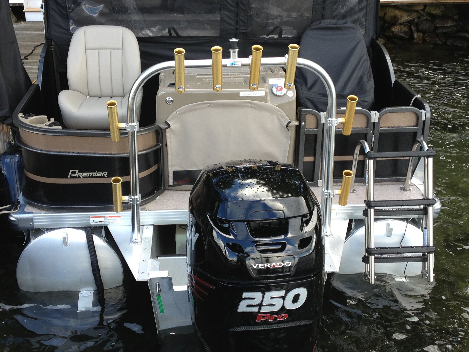

Tip Thompson makes a pretty decent downrigger bracket for pontoon boats. Very simple to install and sturdy! They can be seen here... http://www.tipthompson.com/index.php?id ... er=product
As far as rod holders go, Scotty's Powerlock holders with their clamp on square rail mount are real nice and do not get in the way of any side curtains or mooring covers. http://www.scotty.com/fishing-gear-equi ... mounts.htm
If your looking to add some rocket launchers and have a ski tow bar on the back, take a look at this pic on how I utilized the tow bar for this purpose. These are clamp on style rod holders that do no damage to the tow bar. I bought them at Fishonsports.com
Good Luck!
