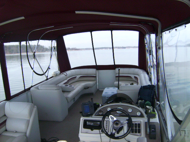

I've had mine for 4 1/2 years now just as you see it. I've never taken it down with the exception for the rear panel that I leave off from Spring til Fall. With my 115 I'm able to make 24 mph with just me and a half tank of gas. We use it all the time for camping. I've got snap up curtians for privacy but so far I've never really used em. I use my boat year round here in NC. It's fun to go out on a 40 degree day with a heater and party on the lake for the day. Advise:
1. Get Glass all around. Don't get the type of enclosure that is mostly canvas and has little rectangle cutouts for windows. You won't be able to navigate well. Plus, taking these things on and off is a real PITA.
2. Have them use Strataglass! I made this mistake and let the fabricator use regular clear vinyl and there is a difference. The regular clear vinyl is a little wavy when you look through it whereas the Strataglass is absolutely crystal clear and you can roll it up which is important for your windows and doorways. I had the front panel replaced with Strataglass and it's as clear as your windshield on your car. I'll probably have the rest of the boat done with the Strataglass soon. Isenglass would be best but you can't roll that stuff up to well and it's a lot more expensive.
3. Have windows on every panel and make sure all doorways roll up as well. I have no problem with heat in the summer with all windows and doorways open. I think it's even cooler since your in the shade.
