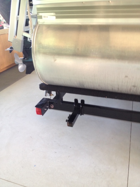

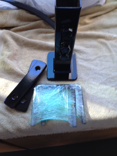

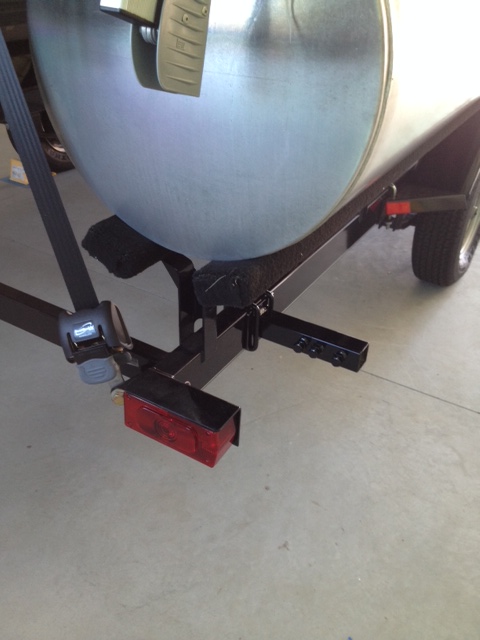

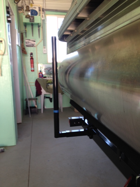

I have fabricated s set of loading guides. These are very sturdy, steel, all welded and powder coated. Pretty basic idea.
I went with this design as during windy days the stern of my toon wants to drift away from the trailer. With these guides the toon should stay between the guides. The bow of the toon appears to not be a problem, as it is aligned and on the bunks when I crank onto trailer (I keep about 3-5 feet of bunks exposed when I place trailer in water during retrieve). It's the stern that was wanting to drift off during loading.
I have not tried these yet. I was hoping for some input on the last part of my design. I will be adding about 6' sections of 2" PVC over the upright posts. My questions are as follows:
1. Should I cut the upright posts to where the blue tape is placed? This is about 9" above base (part that mounts to trailer). I would then place the 6' PVC pipe over this 9" metal upright. This would insure that in the event I came in too fast during loading, my boat would destroy the PVC before causing damage to pontoons. The 9" cut off point puts the upright posts below the bunks.
2. If I leave the metal upright pipe at its current length, do you think I run the risk of damaging my pontoons in the event I came in too fast during loading?
Any input/critique on my design?
Thanks!!

Just measured installed.....1/2" gap between post and side deck rail, is 8'-6". I would have liked to have 2" gap on each side but that would put me at 8'-9". If I cut the metal posts down to 9", the PVC should flex 2"-3" when boat enters between guides, correct?

I really like your principal idea. Fact is I may fab one up real similar for myself. The real change I'd make is I'd make it up like a receiver hitch that you'd find on your tow vehicle. When ready to load the boat slide the upright hardware into the hitch and insert pin, load the boat pull the pin and remove the hardware and stash it away until it's needed again. It would then be clean out of the way and unoffensive to others sharing the road as I'm motoring down the road.

I like your suggested idea of the hitch pin. Makes it quick and easy to remove. I was thinking of adding pipe lites; this wold not make them easy to remove. Mine are made of square tubing so I could convert to pins if desired. I just hate to have to store them while en route to/from lakes.Bamby wrote:I really like your principal idea. Fact is I may fab one up real similar for myself. The real change I'd make is I'd make it up like a receiver hitch that you'd find on your tow vehicle. When ready to load the boat slide the upright hardware into the hitch and insert pin, load the boat pull the pin and remove the hardware and stash it away until it's needed again. It would then be clean out of the way and unoffensive to others sharing the road as I'm motoring down the road.
