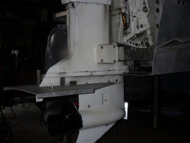

sorry i screwed up meant to post more than 1 pic.
bamby, thanks for asking but yes i have used trim,i actually find little difference in rpm or speed although to low and sprinkles water on passengers,motor run best at almost neutral can trim full up and alittle more before prop ventilates (using g.p.s. not seat of pants) i think the prop i'm using is not a good bow lifting prop.

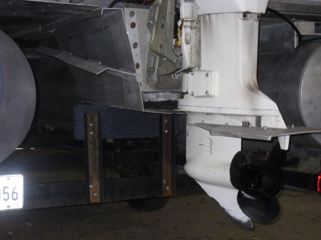

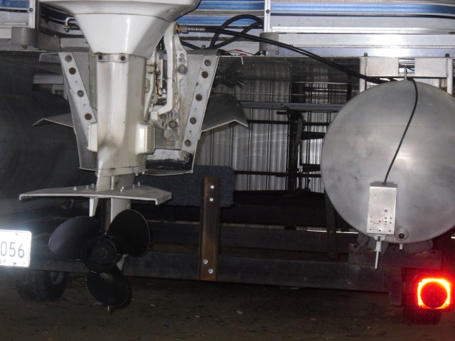

Those wave deflectors, (or whatever they're called) on each side of the motor pod...looks like they could really change the flow of water coming out the back, especially since it's has underskinning. I haven't seen those before, are they factory installed by smokercraft?
Seems to me, those fins could really disrupt the water for a good prop bite, cause drag, or effect performance at mid/high speed.

those deflectors are original i think i bout boat at least third hand and where there when i got it.the under skinning me and the wife did last summer.man what a difference that made. i would recommend everybody do it.(i learned about that from the good people here) thank you all

It seems like the angle of those wave deflectors would act like downed trim tabs, raising the rear, forcing the bow down. What was it like when you were running without the "doel fin"?, one could be fighting the other.

they may be acting as down trim tabs,hadn,thought about that. if so don't no how to correct than or even if i should try.i've seen alot of pontoons with them but never thought about any effects of them.the 14x10 ss prop i have seemed to be a better bow lifting prop.but wrong for this setup.when motor was at lowest setting back 3-4 ft of toons was underwater so bad that water was being forced up through a drain hole in deck that was no longer being used.

Your DoelFin (generic term Whale Tail) will certainly change running characteristics. I've used several brands on regular boats and pontoons as well, with mixed success. They seem to be very individual as to what they will do for any given boat. Shape and size DO matter
The whale tails are usually used on rear heavy small boats to bring the nose down and reduce 'porpoising'. They can sometimes help faster boats reduce cavitation in turns. Pontoons, they can help reduce straight line blowout. They are pretty good in general to improve hole shot. They DO increase drag to an extent, but sometimes it is offset by the other gains. All a guy can do is try them.
Back to your jackplate: The first shot shows that your motor can go up another inch or so before getting lost behind your pod. A jackplate that gives you setback also gives you more headroom to lift your motor, because the water coming off your pod now has six inches to 'rise' before contacting your cavitation plate. It's not too much, maybe an inch. This would give you about two inches you could go up with a plate, which is all drag reduction. Up to you whether you want to risk the time and ching. I'm not convinced you'll get a whole lot more, but I've proven myself good and wrong in the past. All you can do is experiment if you're feeling frisky.
