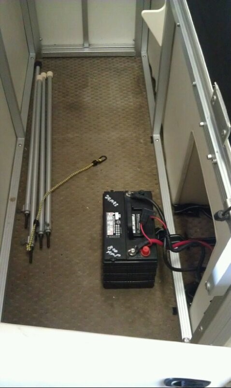

Thanks guys, I was supposed to be repainting all the baseboard trim, interior doors, window frames, etc today, but researching a battery switch install is far too important to put off any longer, heh? I was directed to a wonderful site, quickcable.com, and they have everything I need to make my own cables, as well as some good video on how to make your own cables. They also have the info that a novice needs to learn before starting. That is just what I needed, and I will be likely using them in the near future. I especially like their soldered lugs that are prefluxed and loaded with solder, all you have to do is insert the wire and apply the heat, with a tutorial video on the site to show you how. I am looking forward to this project. Here is a pic I hope of my current setup (how bout that pun! Current, get it?). My 2003 Bennington has only small cubby for the single battery...hard to drag the thing out. Once I do away with the pop up privacy hardware, I will add the second battery near the first, perko switch and my stereo amp as well. Its a strange looking way to provide a battery compartment, but I guess they were trying to maximize usable space elsewhere.

I have the same changing room as you on our Bennington. I stuck the deep cycle battery at the far end of the changing room just behind where the porta potty resides. Ran the big-ass wire (think #2 or 4) up to the Perko switch that is mounted just to the right and high of the starting (original) battery location in the little alcove. Works out real nice and can still use the changing room for what it was designed for (privacy). While I was doing all that, I added a pair of high current cig lighter plugs just outside the changing room.

Drago, I will have to wait till I get home to view the pics you posted. The factory I work at filters some of the image hosting sites...I am doing away with the pop up privacy since we never use it, and the framework is annoying to deal with for me. Your location of the second battery is where I want mine too, less the porta potty. That is the only down side to my bennington, only one battery setup from the factory and a tiny compartment that is hard t access.
