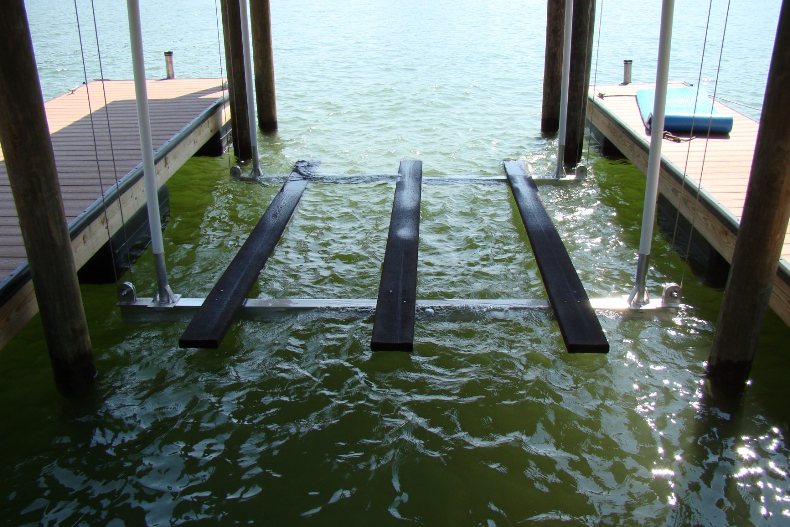

This is ours and we've never had a problem.
- DSC00032 [Desktop Resolution].JPG (440.04 KiB) Viewed 1749 times

Re: Why Not?? (for all you lift owners)
Carl - thanks for the pic. My idea/thought/question is take what you have and ADD several 2x10 (or
perpendicular to what you have - this would basically create a floor.
All the pontoon lifts on my lake look like this
or this
running the length of each log (just like bunks on our trailers). I agree with the point that the above configuration supports the entire length of each toon whereas my idea would have 6-8" (maybe more) gaps.
.....just thinking out loud.
Thanks for the feedback!
or this
A lot of those on Lake Tenkiller. It works great as you can stand on deck to clean or cover your toon. A few have a slot in back where lower unit fits so you have complete access.
I've always liked Carl's triple first class lift, and with the pulleys he's doubled the lifting capacity.
Mine is a budget version of that with double boards flat under each toon.
