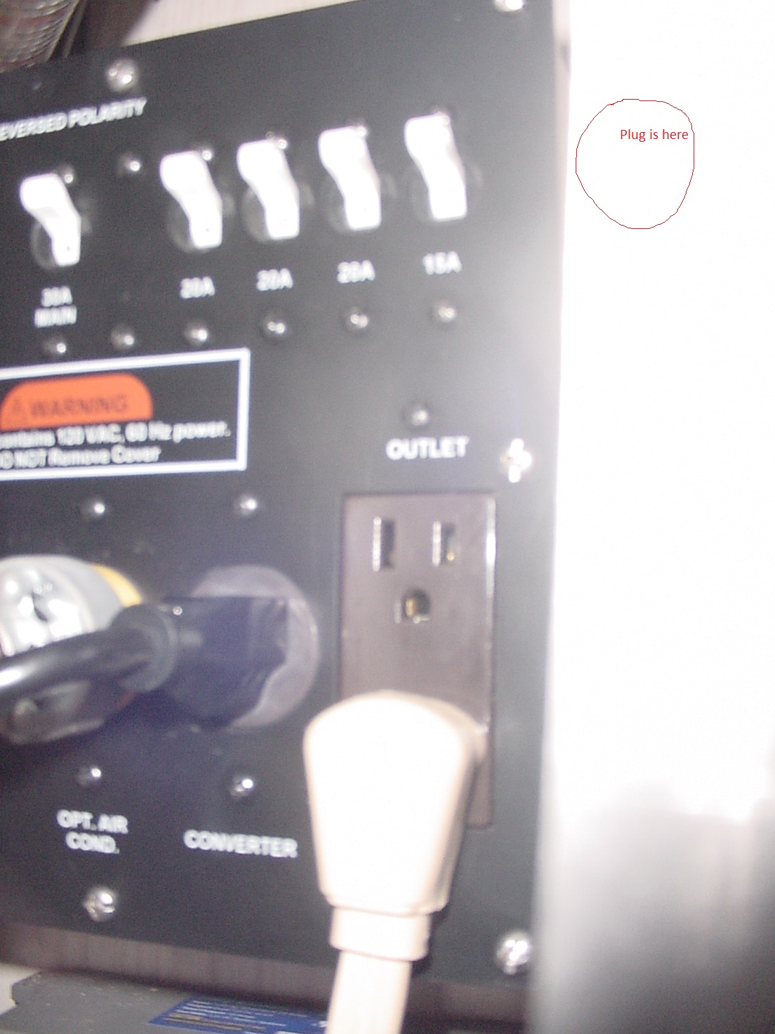

DavidSkylark wrote:Just bought a honda eu3000is. I plan on installing it on the roof of the party cruiser. I also plan on installing an ac unit. I was wondering if anyone had any thoughts on which unit is the best bang for the buck? How are you wiring the generator to the existing electrical system. I have had no luck with finding a wiring schematic for the boat. Would love to hook generator up internally through main shore power line but not sure if it is a good idea. Just bought the toon last month. Excited to find this forum. Good information and good people. Thanks.
David, the Party Cruisers have a plug in on the side of the electrical service panel. Just plug right in. My 2006 PC had it. It's well hidden, open the cabinet under teh stove and it's right there on the side of the panel facing towards the head/shower area.
I used a Honda EU 2000i and it ran the A/C and everything else (microwave etc.) fine. It's covered by a black plastic plug.

Re: Onan micrquie 4000 installation.
It's so cramped, I could never get a good pic of it, lol

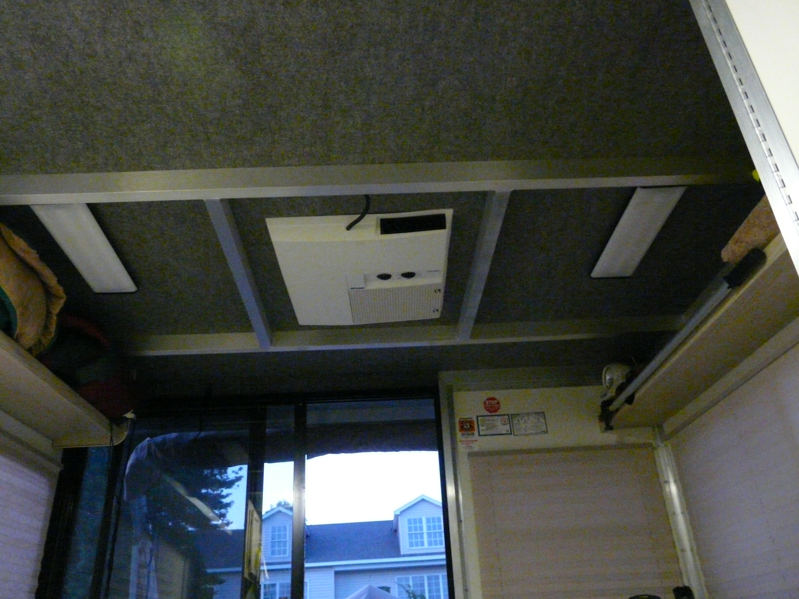

Mine had a Dometic Brisk Air 2. The entire boat, even the stern sleeping area would get really cold in 10 minutes, worked well. I just put the Honda Generator on the roof on Eco throttle and you could barely hear it running. I never permanently installed it because I was afraid someone would steal it.
