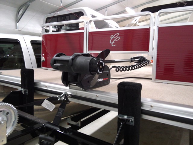

If it's a tritoon, you've got limited options. Mine sits on a quick release mount under the front gate and the gate is only open for deployment. Underway or stowed, the gate is shut. That being said, if it's stowed, the motor can be a potential trip hazard. Given how easy it is to take off, I usually leave it on shore if I'm planing on just cruising around with family. If you had the space, you could always put the motor to the side and only connect it to the quick mount when you wanted it I suppose.

I have mine mounted on the front, with a quick release bracket, but we do a lot of fishing, so the motor never comes off. It is a bit of pain sometime, but the control is much better on the front. I did off set mine a bit to one side, so still pretty easy walking through the gate.
