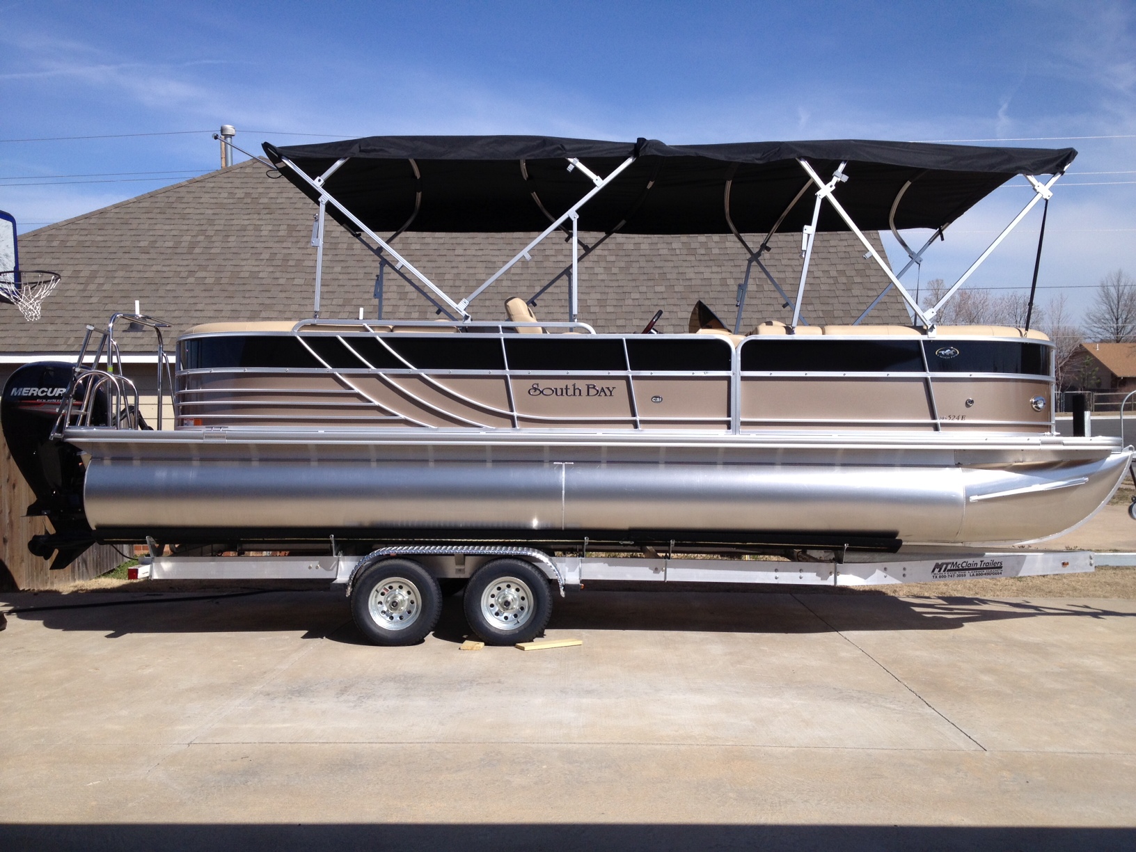

I was going to repower my 2012 Southbay twin tube with a 115 to a 150. Knowing without strakes I would not gain much , I went to a local Southbay dealer and looked at a sport tube with a 150 for 35,000. Same layout I have , 522CR . What I dont get is why SB does not strake the center toon of the sport package .
Anyways I stopped across the street at an Avalon/Crest dealer and looked at a Crest III 250 that they have at as " boat show special package" . It had full teak flooring , cp3 3rd toon with strakes , outer tubes have inner strakes as well, , Powdercoated rails , Bluetooth stereo, lighted cup holders and speaker grills, stainless enertia prop ,integrated tow bar, 47 gal fuel cell,high back helm chair, underskinned, stainless ladder ,Bumper storage box, stainless rub rail, and a 150 Merc fourstroke.. Priced out the door at 41,750.
I have to say , I was impressed with the quality of Crest. Never considered one before but at that price , I may just jump ship. I love my Southbay but I cant get into a full tri toon for that price. Thoughts ?

Having researched this before, South Bay does offer a straked Sport Tube. Just have to ask for it. I was quoted from my dealer around $2800 installed. Not too bad if you as me just havent done it yet as I am holding out to do a full length center tube and 250 Verado at some point down the road. Crest makes a nice product, but in my opinion not to the quality of South Bay. There is a reason Brad Rowland (World Record Holder for Top Speed in a Pontoon 114mph) runs a South Bay. They are very well made.

I tried to order outside tube strakes and a sport tube with strakes. Southbay would not weld them on the sport tube , I would have had to buy the tube without strakes and have them welded on myself. No dealer in my area would install a sport tube after the fact . They all said I have to take it back to Southbay. Southbay also did not want to do it . They basically said I would be better getting a different boat. Cant blame them for that I guess.

I am curious as well if there is any testing between a Tri-toon with a sport tube with only inner strakes on outside tubes vs. a Tri-toon with a sport tube with strakes also on the sport tube. I’d be curious if the 2 inner strakes on the outside tube are enough to get the boat up and out of the water and the center tube strakes would be diminishing returns?
I myself have a South Bay chassis with the 3rd sport tube, but only strakes on the inner of the outside tubes.
I guess there is a possibility that additional strakes are more for marketing than actual function once you have a certain amount.

Cycleman, when you say full length tube , are you referring to adding to mine or buying a new boat ? I cant get anyone to install a sport tube let alone a full center requiring the transom work etc. That would be real costly.
I have another request in today at SB asking about the sport with strakes , figure I could bolt that on myself . She was going to get back to me. But again Im looking at 12-13k for a motor upgrade , sea star, tube purchase , welding etc.
Maybe Ill just weld the outer strakes on mine now and see what it does with the 115 . At least that would be under a K

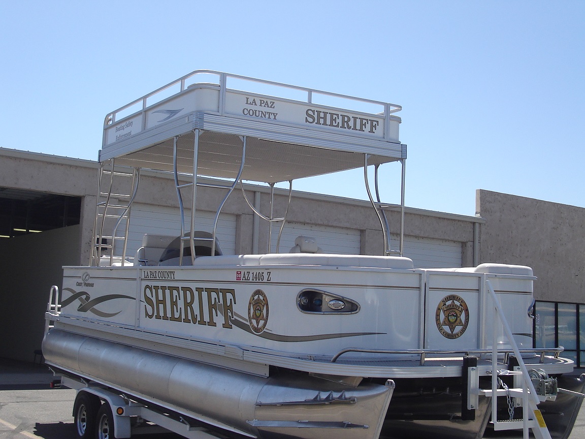

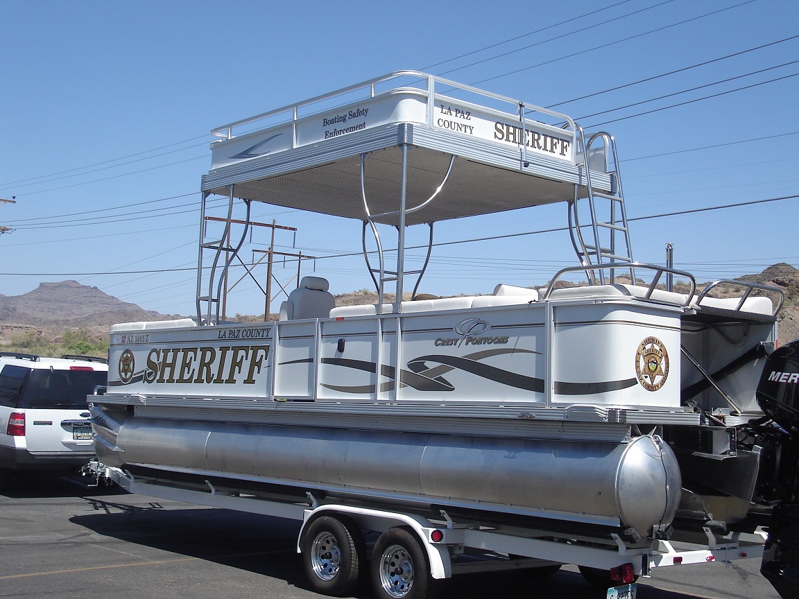

This is our 27' Crest tri-toon with the upper deck & full strakes. Powered by a Merc 150 Verado. Two fuel tanks, one in the center toon, midships and the second in the rear well.
It's a well made boat and plenty plush. We're happy with it, and I'd absolutely LOVE to have it for myself. (without all the cop stuff on it, though)
We can pull 36 MPH with 2 aboard, and that's with the heavy ass top deck. Would likely get low - mid 40s without it.
