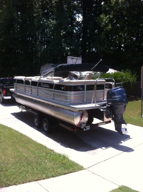

#3 Post by Capt Sully » Mon Mar 17, 2014 7:34 am
I looked and I can't remove the factory installed tow bar. it looks and feels very strong heavy and thick. note the brace, you will need to add that. Good luck with your build.

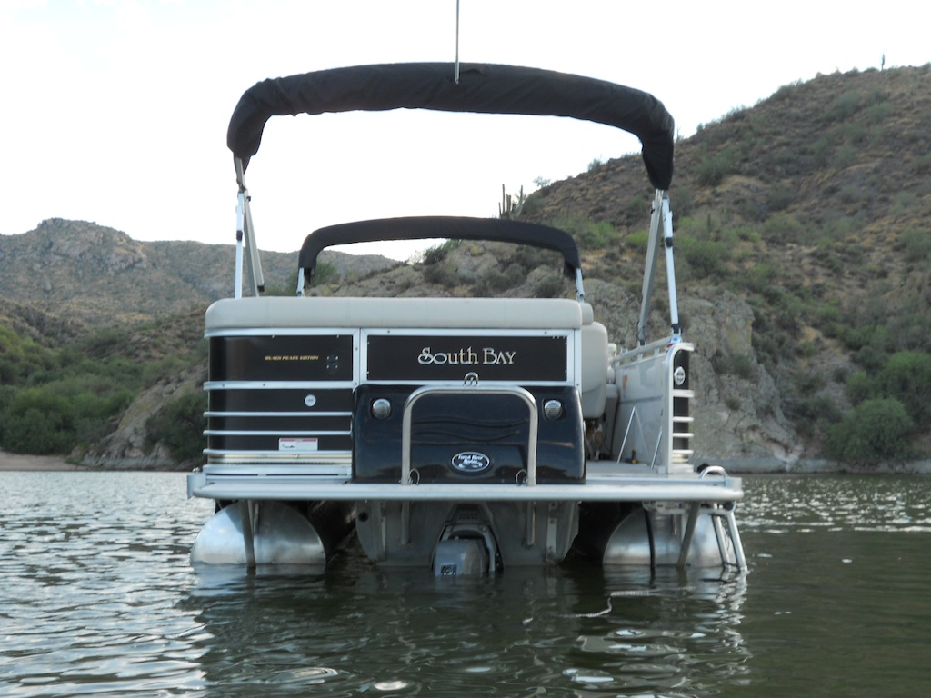

Tuned,
Is this one like the one you are fabricating? If so, I can try to get some measurements for you later this week. It does remove simply by pulling out two thick cotter pins.

Re: Yet ANOTHER Ski/Tow Bar-need specs
#9 Post by tuned » Thu Mar 20, 2014 12:55 pm
woolznaz wrote:Tuned,
Yep, that is indeed the one. I just couldn't find a shot of it. The only spec I really need is the gauge of the tubing if you would be so kind. Thank you, thank you, thank you :bowdown

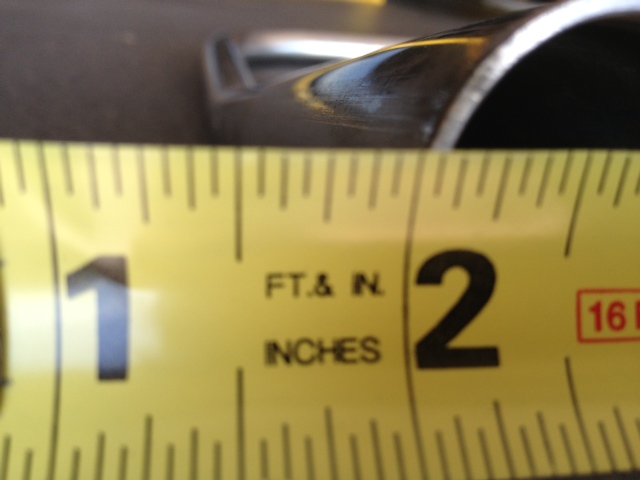

#10 Post by woolznaz » Mon Mar 24, 2014 9:47 am
Tuned,
It looks to me like the thickness of the steel is about 1/16". It was kind of hard to hold the tape steady and still take the picture, but here you go. From this angle, the picture makes it look like it could be a little heavier, but when I put the camera down and carefully measured, it looked like about 1/16". I know that is all you were asking for, but I took a couple of other pictures that might be helpful for your project. I'm happy to email them to you if you want. Shoot me a PM and I'll send them your way if you are interested.
yep...1/16 is correct from my understanding. Be careful on the eye part where the rope attaches. Needs to be welded by a pro. My South Bay tow bar is incredibly strong and the welds on the eye are incredibly thick.

#12 Post by tuned » Mon Mar 24, 2014 5:15 pm
Wow. I can't believe 1/16 is strong enough, but the picture doesn't lie. Think I'll go 3/32 just to be sure.

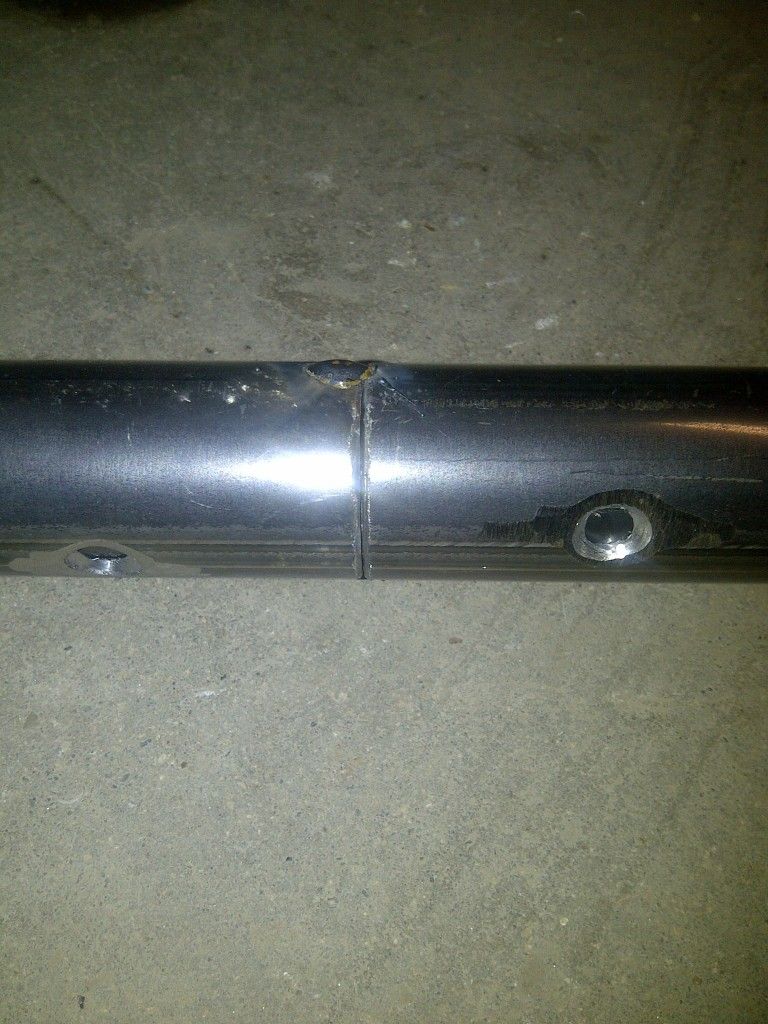

#14 Post by ronb » Fri Mar 28, 2014 3:25 pm
Well this all makes me feel better about mine.. I used 1/8" tubing and the center foot where the rope loop is double walled... 1/4" thick and welded with a few rosettes along the way.
But not very stock looking... it also was bent by a local muffler shop. He didn't have dies that went down to 1.5" though, so they aren't quite perfect. Something to think about.

#15 Post by tuned » Fri Mar 28, 2014 5:34 pm
ronb wrote:Well this all makes me feel better about mine.. I used 1/8" tubing and the center foot where the rope loop is double walled... 1/4" thick and welded with a few rosettes along the way.
Where the heck ya been ron? Questions: When you say double walled, do you mean an inside tube? I can't tell if this is stainless or not. Finally, my exhaust guy says that without a 'sand-filled' bending setup, he will get a couple of creases at the 90 degree bends. I can't quite tell if yours did this or not. If they are on the inside of the bends, I could live with that.
