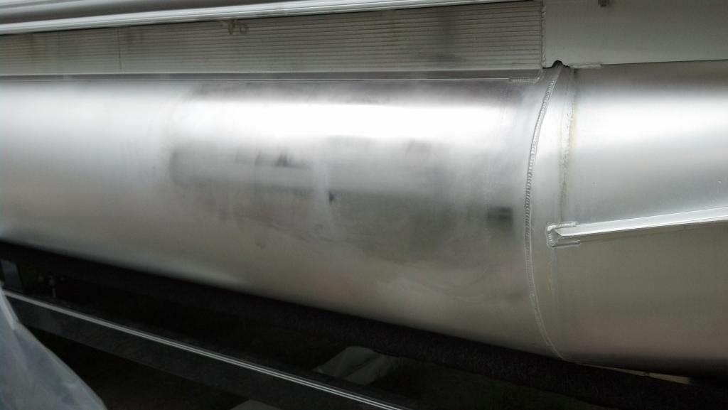

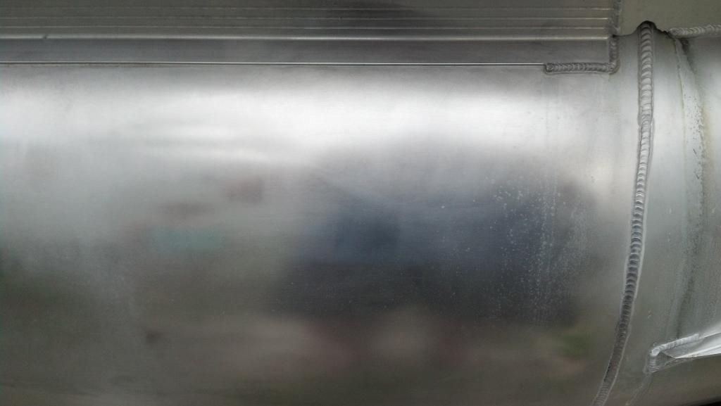

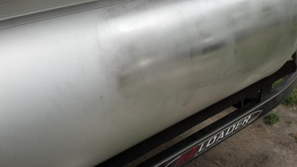

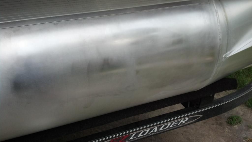

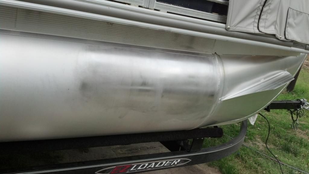

I am trying to polish my toons this weekend and things are not working as planned can anyone help? I have done the acid wash with the Sharkhide aluminum cleaner then wiped everything down with lacquer thinner and started polishing this evening. I am using a new polisher with a Meguiar’s 8” wool buffing pad and these are the results I’m getting. This is a brand new South Bay that has only been in the water twice so the toon were in good shape to begin with.
2014 SouthBay 522 FCR
150hp Yamaha

All new toons are anodized from the factory. You need to cut through that first. Use a cleanning or cutting compound first, or even sand with 400 grit.

ToonGuy wrote:All new toons are anodized from the factory. You need to cut through that first. Use a cleanning or cutting compound first, or even sand with 400 grit.
Do you have to remove the cutting compound with lacquer thinner before you start polishing?

If you polish correctly, there is little to no residue left. If you have alot of compound left when you finish an area, you are using too much.
