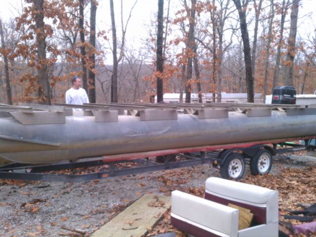

Go get some Tripoli and save your self time instead of using the milder polish, even with Tripoli it takes a long time to get it done
It's worth it as we got nothing but complements since the first day it went back in the water.

HandymanHerb wrote:Go get some Tripoli and save your self time instead of using the milder polish, even with Tripoli it takes a long time to get it done
Holy hell Herb. Thats amazing!

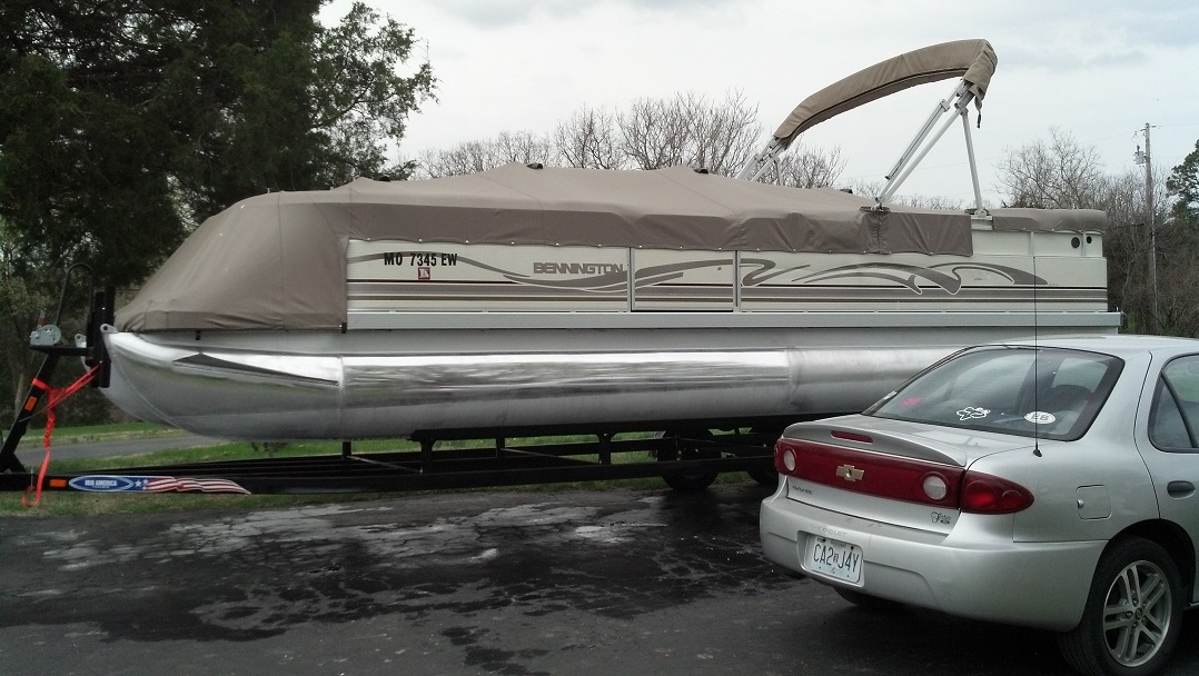

Got a couple hours to spend on polishing today. I had something to do in the afternoon, so I knew I wouldn't get too far. I still need to give it a rubdown with lacquer thinner, but so far, so good. I only went down to the waterline at this point. The sharkhide metal polish seemed not to be able to do much with stuff under the waterline, so either I need to get some Tripoli as Herb suggested, or I will leave it like that. I'm kinda digging the 2-tone look.
Again, about 2 hours work so far.

almost there. I ran out of polish, so still got a bit on the right side left to do. I also need to give it a good soap and water wash now, but here's what the right side looks like..
It's slow going, and my polisher tried to kill me a couple times, but man! what a great look!
