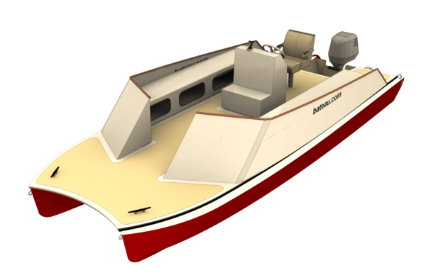

I have been talking to several boat designers and can not find the exact thing I want which is a pontoon type deck with catamaran hulls. Richard Woods has a design called a Skoota 28 that has the hulls I want to use. Here is a link to it http://www.sailingcatamarans.com/index. ... -skoota-28 It uses twin 20 hp, weighs about 5,500 and the 20's push it around 17 to 18 mph all day long. The shape of the hulls being the main differance. The designers I have talked to all tell me that a round tube while being efficient at holding up the load will always take 3 to 4 times the horses to push it. I want about 36" of clearance under the deck to the water when loaded. I'll post a picture of (close to) what I want.

I would like to build one simular to the picture as a 10 X 24 with around 20' usable deck made in 3 or 4 pieces. Still undecided on what type of wheelhouse but I do know I want it off the water by 3' I keep thinking I want to play in the Gulf of Mexico a bit. If, and that's a big If at the moment, I want to power it with a pair of 20's and have the whole thing with motors and fuel weighing around 2,500. I have the hulls figured out with some alterations to the plans for the 24' one in the picture and the Skoota 28. Both the hull shapes are within a degree or two of being the same. The Skoota is just larger and uses stringers. The 24' has no stringers and is using the chines to stiffen the hulls. I don't like that idea so much.

Playcat, None of them build one like the picture above and, most of the smaller (less than 35') catamarans are fiberglass, very heavy, and more like a tunnel hull than a catamaran. None of them are 10' wide and none of them can be dis-assembled, trailered, and re-assembled by one person. I have been looking for about 6 to8 months and if it's out there, I can't find it. If you run across one, I would sure like to have the web address.
