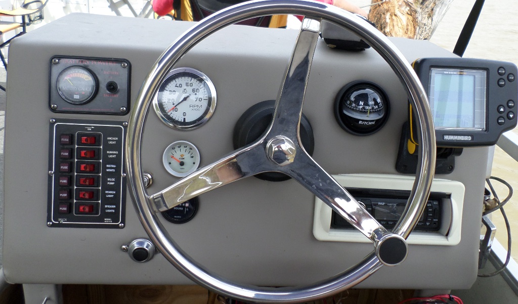

Thats the very reason when i did my rebuild a few years ago. I stripped out all of the old wiring and started fresh With 6 gage wire to a new 14 circuit ATC fuse block and over time i added the instrument I actually needed. While not matching it gets the job done. The compass was the last touch.
- compass installed.JPG (235.75 KiB) Viewed 1108 times
