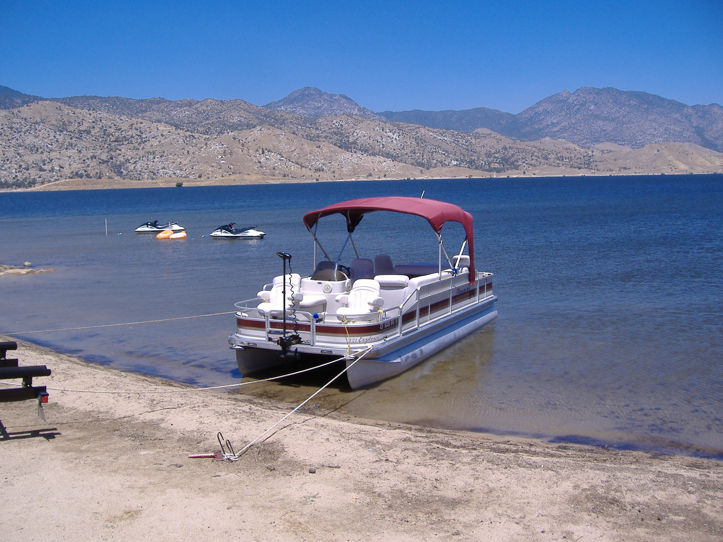

I have that same setup on my toon you just adjust the locking ring to the depth you want the motor, when not in use just pull it straight up an let the lever lock it up.
I will look for a picture of mine.

found this pic of it in the up when not in use.
might be a bit large pic ...sorry
