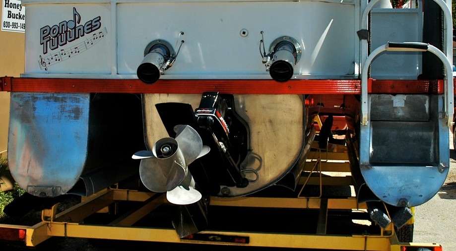

by pond tuuunes
here is the best shot of my strakes.JT
