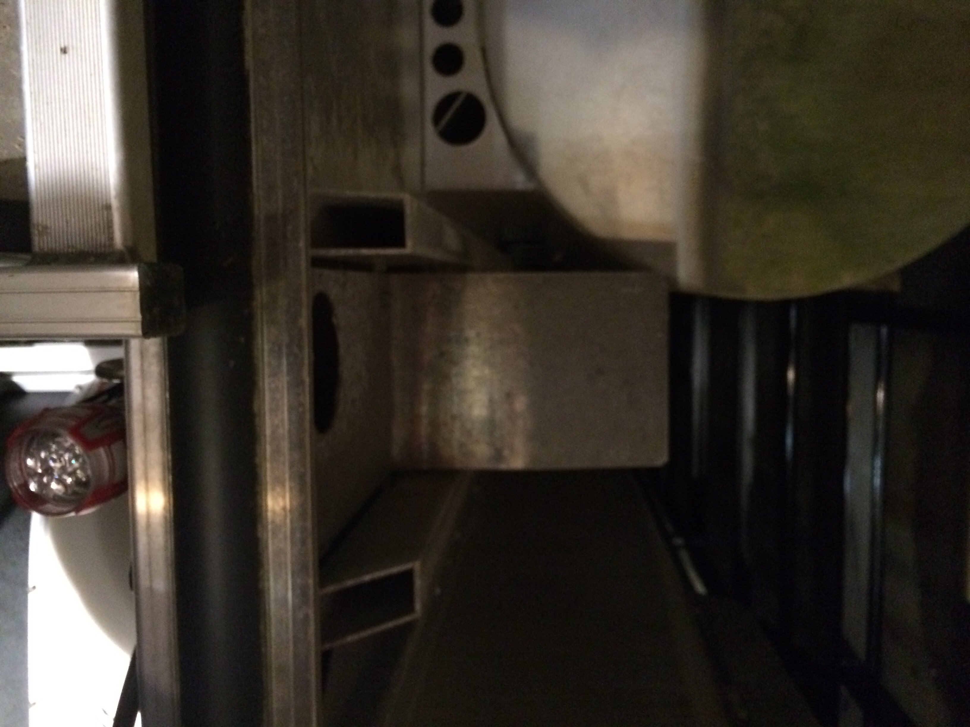

Hey guys got the boat home and found a bottom skin plate that was bent straight down acting like a "hydrobrake" so I hope it goes faster than 19 mph
Anyone know how much water storage there is for the sink?

#11 Post by smuckie » Sun Jun 15, 2014 6:22 am
Sorry about double pics still learning how to use forum

#12 Post by Waterlogged » Sun Jun 15, 2014 3:23 pm
Smuckie my prop is 13.75 X 15 pitch. I have to watch my RPM because if I'm not careful it revs up to 6600 way past the 6400 redline. No idea what the water tank holds. Oh and the picture is waay to big, can't see what it is.

#13 Post by smuckie » Sun Jun 15, 2014 3:59 pm
That's only cause cause I don't know what I'm doing with attachments:-) but I need to see what's up after I fixed the bent plate, that had to be dragging the boat down, I'll try to load a smaller pic

#14 Post by smuckie » Mon Jun 16, 2014 12:06 pm
Is this better
