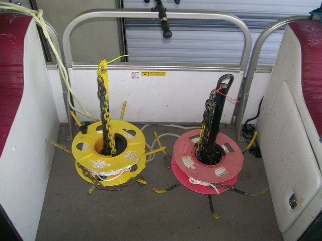

storage can be an issue depending on how you use your boat, but this style is hands down the best anchor I've used. I made these from scraps laying around my shop so they didn't cost anything. They will hook on any type of bottom. You can't exactly throw them under a seat though......
