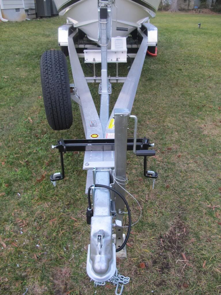

Anyone installed a trailer sway arm on their pontoon trailer like this?
http://www.campingworld.com/shopping/it ... aQodSwcAYw
Need something to help, but the tongue on the trailer is too long to work for these products, as the "A" starts really far back from the hitch.

I think this might just be the solution, a pole tongue adapter

We had an equalizer hitch from a previous camper. I installed the pole tongue adapter and it worked very well.
