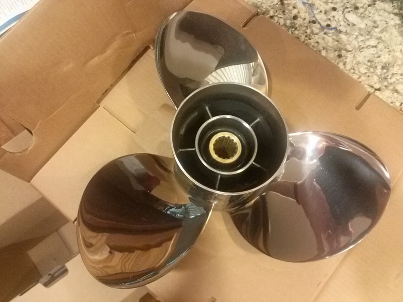

This just got delivered today. I'm like a kid in a candy store. I can't wait to put this on the boat Friday morning and see how she runs. I'll report back this weekend.

A new stainless prop is a pretty thang. It looks like a very high quality piece.
I used to go thru an aluminum prop every year on my inboard outboard boat. When I got a new I/O, I went to a stainless prop and it lasted me 11 years--until the thrust bearing bolts fell out and my engine locked up. I scarcely ever had a scratch on the stainless prop. The investment in the stainless prop saved me big $ over the years.
When I got my new Bennie, my dealer set me up with a Yamaha M 14 pitch prop. It was about 3 mph slower than expected and I easily hit the speed limiter @ 6300 rpms. They ordered in a Reliance 15 pitch for my F150, and it's right on the money @ 6000 rpm's. I would consider it comparable to the industry standard (for pontoons) Mercury Enertia propeller.

The Yamaha Props are pretty darn good, Yamaha bought up Precision Propeller a few years ago and many of the newer "yamaha" props are renamed Stiletto/Turbo props. I have the ported "Turbo pontoon 1" version of the Yamaha pontoon performance and it has worked great the past few years. Can't go wrong with a powertech either, I'll be looking at a Powertech 4 blade when I get my 70 swapped out for a 115hp
