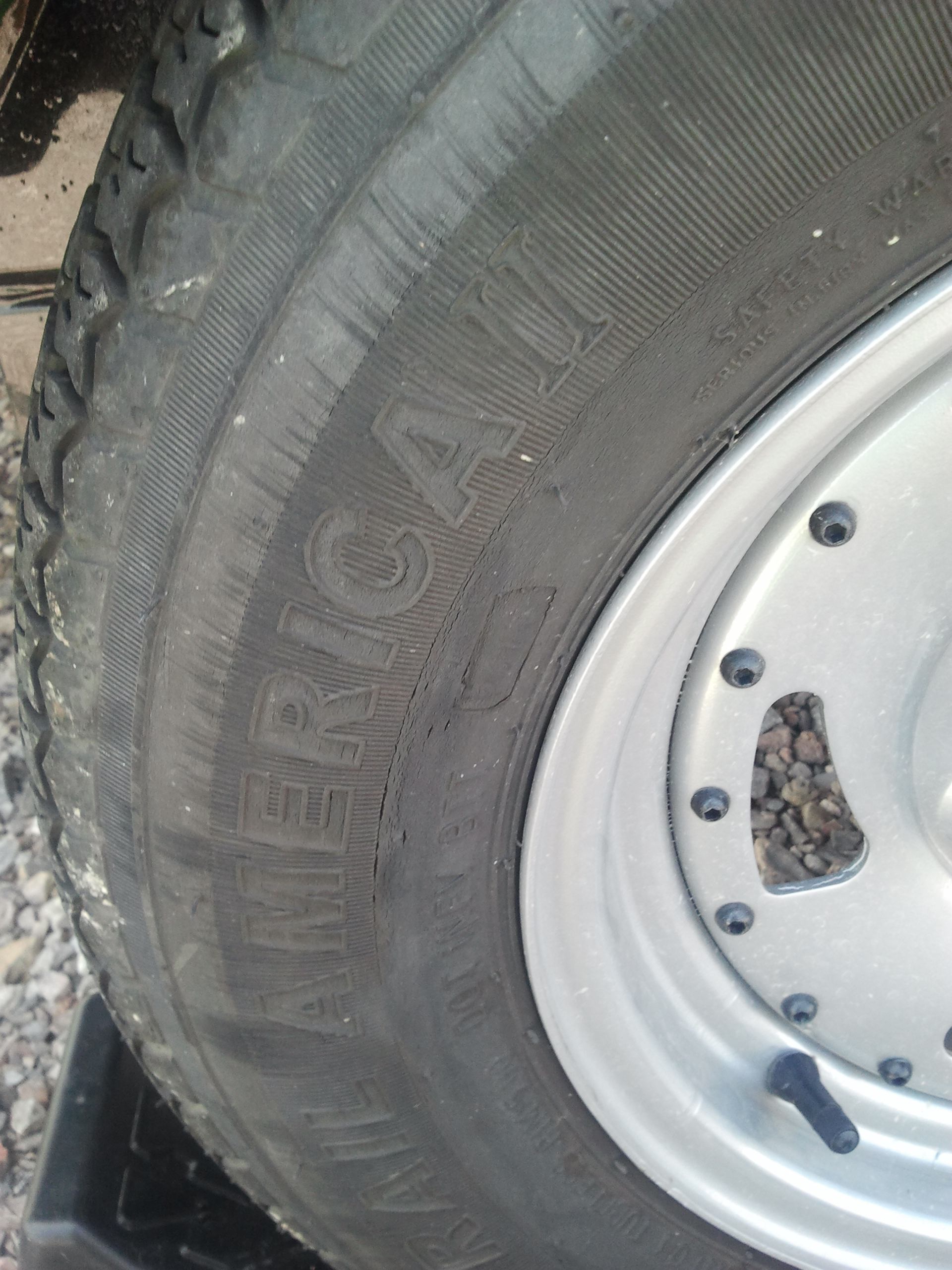

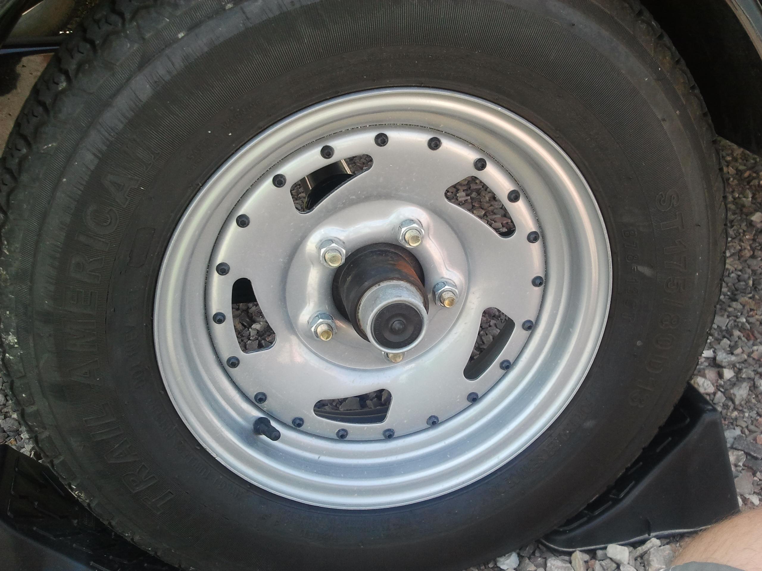

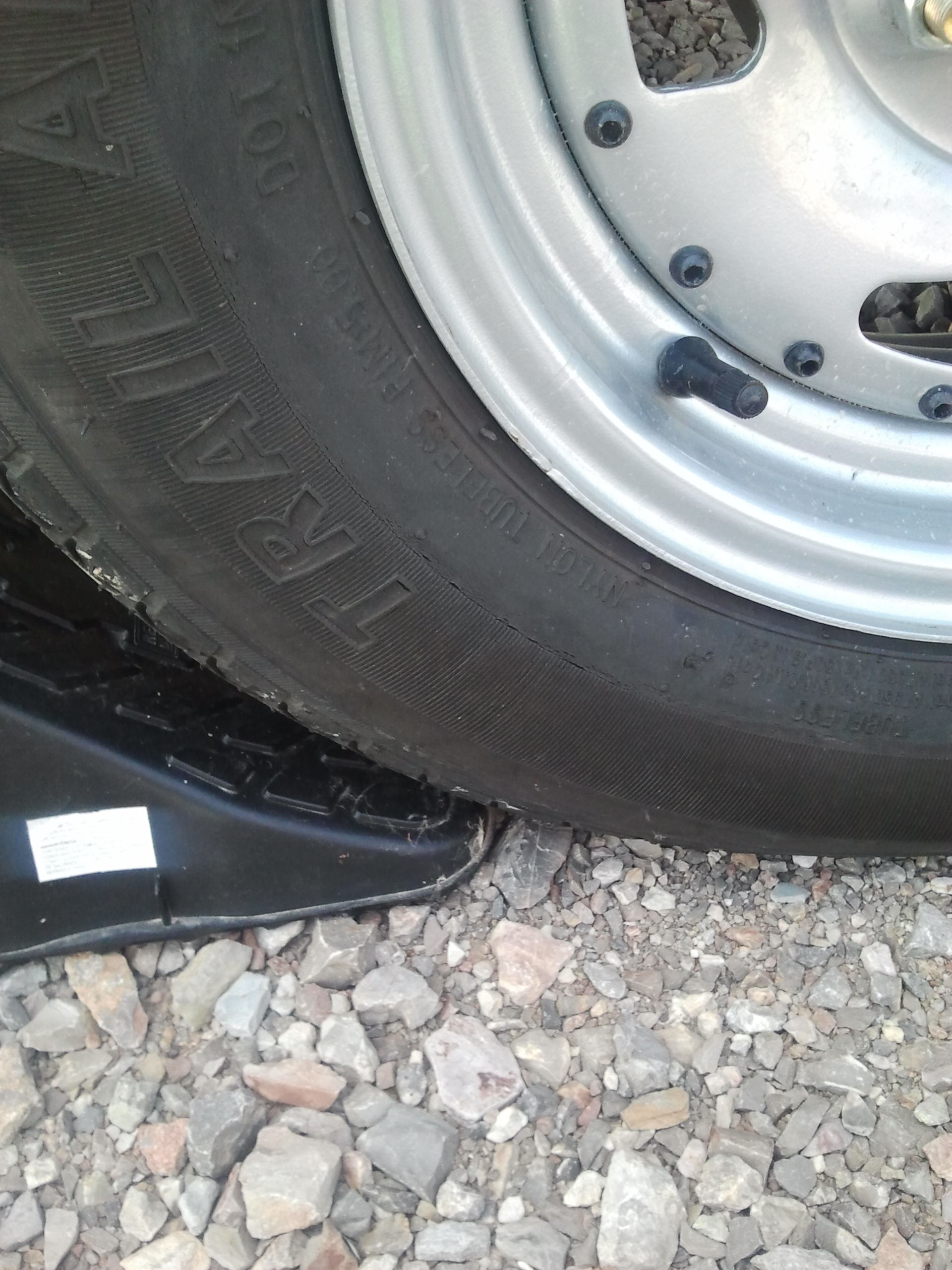

Hey guys. I have a tire question for you. When I was pulling the boat out of the water today, I rubbed one of the tires on the curb. No big deal, but I took a really close look at both of them. That is when I noticed it.....CRACKS!! :scared
Ok, they aren't that bad, but I wanted to get your opinions. Do these cracks warrant replacement? I think I know the answer, but I figured I would see what y'all thought. The boat was purchased new and is only 6 weeks old. How in the heck are there already cracks?!?! :donno I keep them at the psi recommended on the sidewall at all times. The other strange thing is that the tire I rubbed on the curb is fine. No issues with cracks on it. Thoughts?

If that's a new rig I say you were sold an old trailer. I would demand new tires.

Looks like dry rot. Demand new replacement tires if you just bought it from a dealer. The info on this site may help you determine each tire's age: http://www.tirerack.com/tires/tiretech/ ... 12203757:s

I agree on the dry rot. That is what you appear to have.
I personally wouldn't trust tires like that with a valuable boat on the highway.
Taking it in and out of the water where no 'roading' is involved? Wouldn't be quite so picky.
But anything that's high speed (0ver 40) or long distance and I'd want better tires on anything I own.

All tires will have a date code on them usually set within a slightly depressed area nearest to the rim where the tags pressed into the tire during the molding process. Usually but not always the date code will be 1 through 52 for the week of manf and the last 2 digits of the year. Looking at those tires I can't quite make out the date code but they sure don't look new with all the weather checking in the sidewalls.

Thanks guys for the suggestions. Unfortunately, I can't see what the date code is on the tire. It's like I left for vacation and somebody took a power sander to my tire. I must really suck at this stuff if I didn't even notice the bad tire when I picked up the boat.
Do you guys think it could be a tire pressure thing? I have them filled to 50 psi which is the pressure listed on the sidewall. Maybe they are over-inflated? I would think that would impact the tread of the tire rather than the sidewalls though.

Those aren't new tires from this year.
Either that or they have a massive disastrous manufacturers defect.
I'd take the trailer to the dealer with the boat on it and let him investigate.

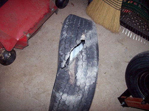

I agree.. whether the dealer replaces them or you replace, either way I wouldn't trust those tires.... I also see that those are "trail america" tires.... Those tires came on my trailer when I bought my benny and you can see the result for yourself below.... replaced both trailer tires and the spare the next week with kenda load star tires... so far so good....

And Trail America strikes again! I've only used them once, never again. I second Kenda load stars!
