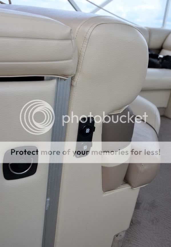

I'll wager the pump overloaded the circuit, especially if it is the helm cig. lighter plug. I had to install a couple of specially wired ones at the back to blow up toys - heavy duty each with 30 amp fuses.
