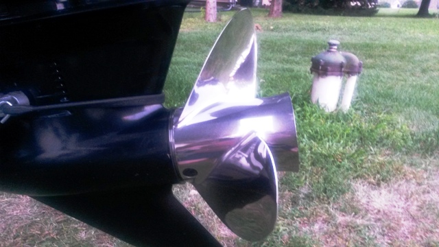

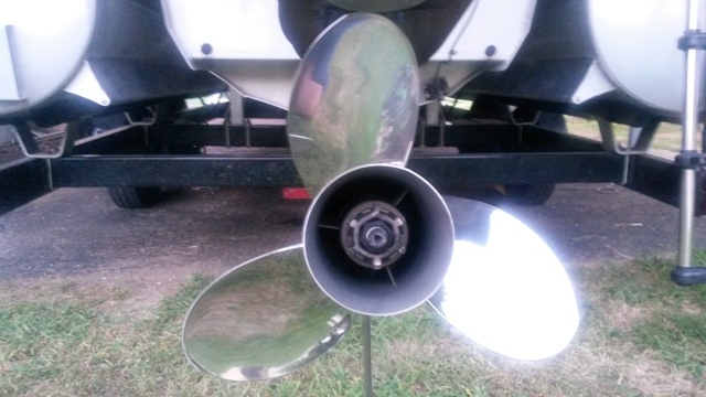

Here it is..
The boat ran 5900 RPM's at 48.6 gps mph. Trimmed just alittle over 1/2 up. The Cavitation plate was about 3" above the waters surface at WOT. You could hear the props ears slapping into the water. From the 19 Mirage plus, I gained about 600 RPMs. From a 17 Enertia, I lost about 300 RPM's. (cupping?) But slip came in at an amazing 5%!!! The fuel economy was great. At 5900 RPM's. 2.9 @ 3500 RPM's 3.6 and at 2600 RPM's 6.2! This is with a 310 horse, 625 pound Verado on a 3200 pound boat! I have never seen that on my SmartCrafts!
I'm thinking dropping the motor down 1 set of holes will help even more with the prop slip at WOT. I called Merc and left a message for them to call me tomorrow. My Rep has left the company (probably for giving out props for free) his email is kaput, We need to find out what this prop is! Because the slip factor is amazing!
As soon as I get more info, I'll let you know.
Beautiful day for a boat ride. Out for about 4 hours went through 1/4 tank of gas.
For the first time out, on stale gas, the boat ran flawlessly. Only hitch of the day, the wife told me she wants a new Manitou, with the same dual windshields...
Greg, (Manitou) if you read this.... The boss has spoken! Lets give her what she wants!!! Give me twin 300's on it, too! I'll help ya design it!!!

Wow. Your report makes me think, wait for the ECO. It's 16" diameter, right? How to explain the increase over the Mirage I cannot say as you kept pitch but went up 1/2" diameter. As for the regular Enertia, well you're stepping up almost 1.5" in diameter so no surprise to me.Bryden24shp wrote:Here it is..
So you think it's the best prop you've ever run on your boat?
Regular Enertia is no good for me b/c of its small diameter. I would be happy in calm water, lightly loaded, that's it. Unfortunately that won't be enough. I need a good all-around prop with tons of lift (bow) and good top end (PowerTech mostly fits the bill, now I am looking for the Merc prop that COMPLETELY fits the bill!). Tip cup really helps my boat lift the nosecones higher.

So for this prop can you tell me/us:
How was midrange power? GOOD
How was hole shot? GOOD
It's still X7 alloy, right? SUPPOSEDLY, looks the same as my Enertia.
I contacted Mercury to find out more on this prop since my contact is no longer with them. No markings at all on it.
Its a keeper, sorry. I'll be keeping it!
