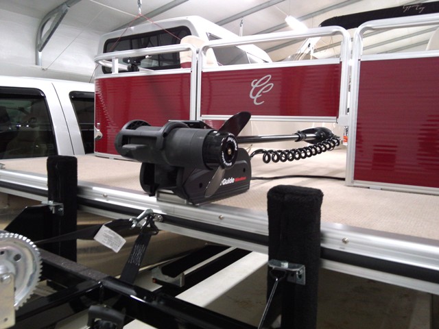

This is where I mounted mine, it works well and does not seem to get in the way like I thought it would. I have a 55lb motor so I only needed one battery and it will keep up with less than a 5 mph wind easily. I have wireless remote which is sweet, I can operate anywhere on the boat.

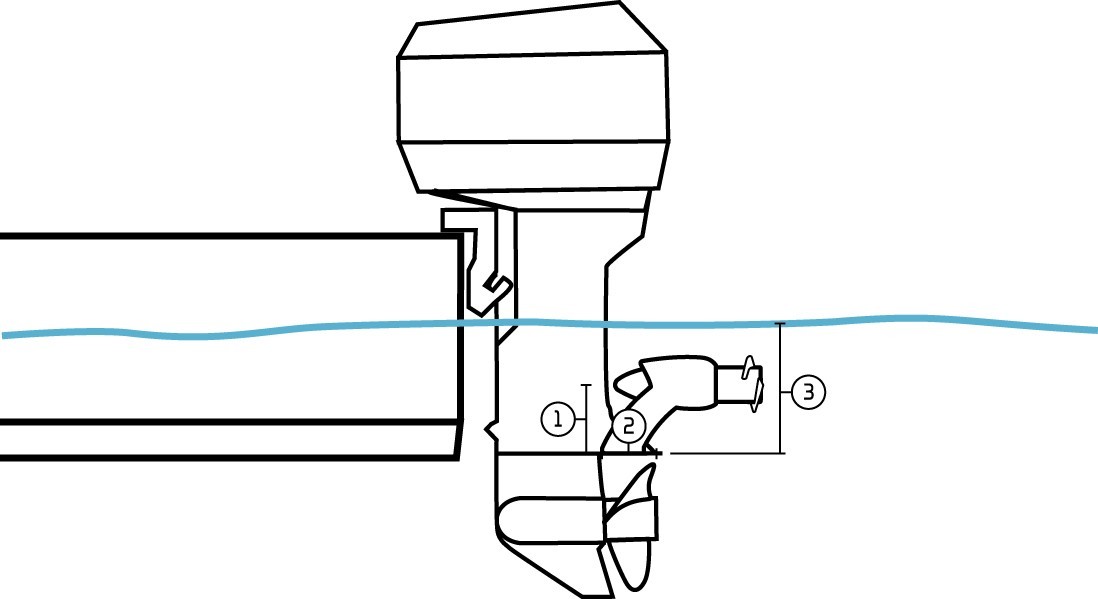

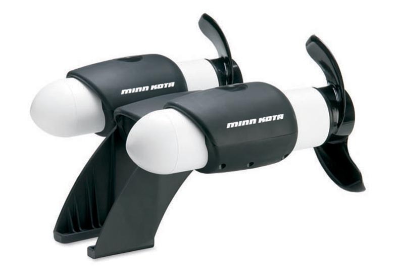

If I ever hit the lottery I'm getting one of these, MinnKota Riptide EM 160 Engine Mounted Trolling Motor (160lbs of Thrust)
plenty of thrust and out of the way. They make a few different models.
