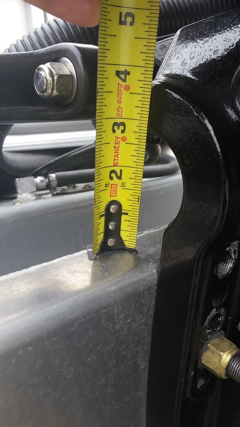

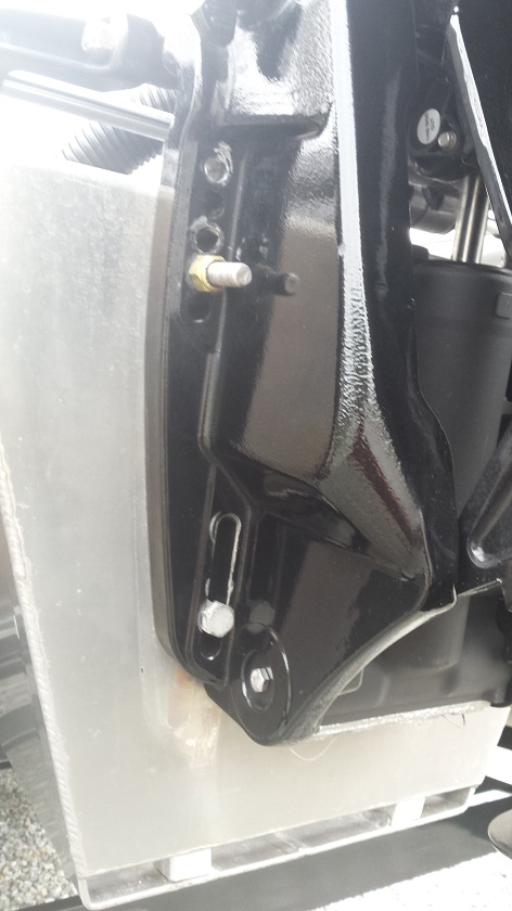

I ended up 3" above the transom... 2014 25' Xcursion
- 20140806_074743.jpg (108.86 KiB) Viewed 4678 times
- 20140806_075216.jpg (130.6 KiB) Viewed 4678 times
2014 Xcursion 25 RFE
2014 Merc 150 four stroke
