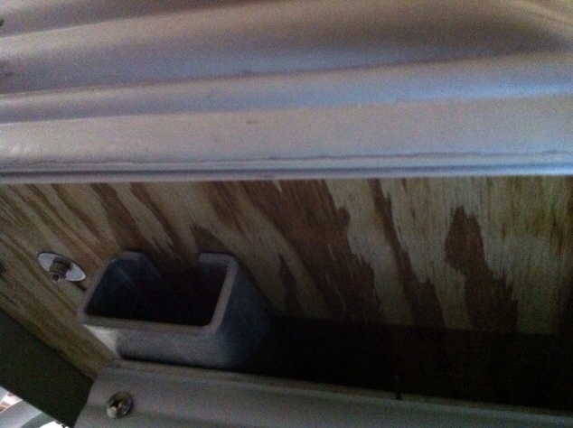

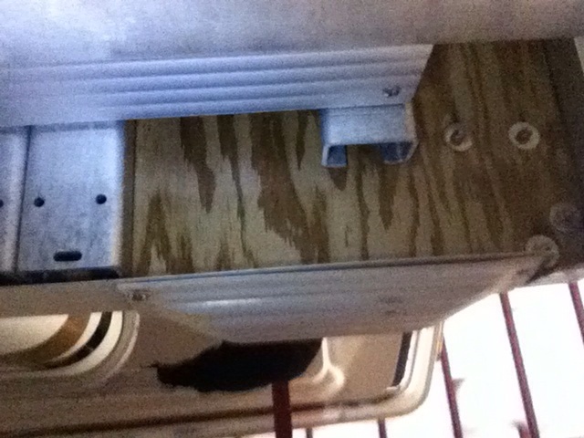

Is there a standard thickness for C channel cross members? Are mine 3/16" or 1/4" (or some other size)? I can't get to my boat for a couple of weeks, which is when I want to install the underpinning, so I can't go measure the cross members before I order the rivets. Here are some photos I took a while back. I hope I was successful resizing the pics.
