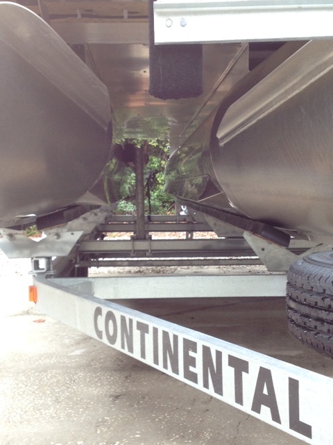

Heres mine, Its just 2" box tubing with the boards attached to them then up against the outside toons. They work well, but I may redo them and make them a little longer. The trick seems to be not getting the trailer in too deep. Ive been on a couple steep ramps to where I dont back the trailer all the way in and bring the boat up to it then back the trailer the rest of the way down. I think a longer board (toward the front) will help fix this problem, but it works perfect on most ramps. The heat index was 122 degrees here today so the boards wont be replaced anytime soon
